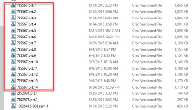

On occasion a part file or an assembly file will become corrrupt. It's not normal
If you are working on a file based system in directories (not Windchill), check to see if you have older iterations of the files. You will likely have to turn on "extensions" in windows to see these iterations. See the screenshot. Notice, it's all the same filename 735567.prt.1, .2, .3. These are each save you did. By default this is how creo saves the files and when you open in creo, it doesn't show the iterations.  You can temporarily rename or move the newer files to test opening the older ones.
Can you share the file to this discussion? You will have to .zip the file to share it. That will allow us to try and open it and see if we can find the problem.
If you can, please include if it is a commercial or education version of creo.

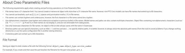

I feel like I'm guessing at a cause here but have you tried moving the file to your desktop and importing from there? Creo has some pretty strict rules about file paths. We occasionally have issues when users open files from really long file paths. File names are another thing to consider if you have illegal characters.
Aug 7, 2023 3:21 PM UTC
Maybe the path name influence the file, In the begining, I set the folder name with the chinese character, and I change it when this problem happen.
