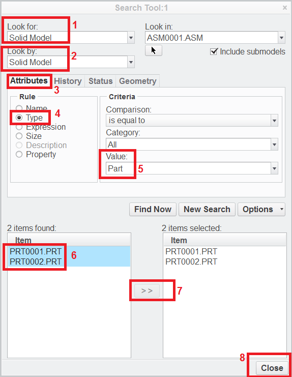

use Search Tool to select all parts - see following picture.
After clicking Close, move mouse cursor into graphics window, press right mouse button and use Regenerate command from context menu.
Note: I am not sure if this procedure resolves your problem, because I did not test it.

Thanks, but that still doesn't force a regen unless part(s) have changed.

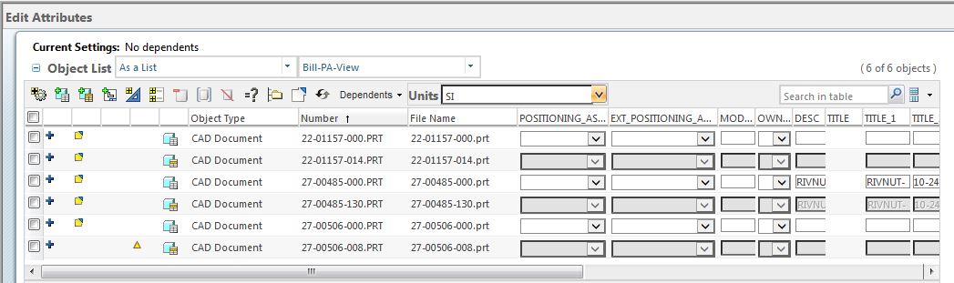

Interesting that you are trying to add Cost information to a CAD object...
As an alternate approach, have you tried to use the "edit Attributes" UI in the workspace to easily modify and populate the cost attribute?  Or maybe you are not in Windchill...but this does open up another possibility of eliminating the need to regenerate if you were.

If you are going to use always the same parameter I suggest using the find tool to select all the analyses features:
Then, supress, resume and regenerate. This may be a way to achieve what you are looking for.
