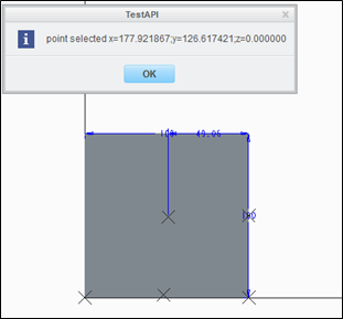

I am trying to get model's dimension location in drawing.
I am using ProDimensionLocationGet () and ProDimlocationTextGet() APIs but the location I am getting I am not able to match wrt to drawing coordinate.
do we need to process the point3d position again in order to conver it in drawing CSYS?i
Thanks in advance
Nikhil
Best answer by mender
177,126 is in world coordinates, to judge by the picture.  You can transform that into drawing units with the trf matrix from ProDrawingSheetTrfGet.

I have created a 100x100x100 mm solid part and paced it on C size drawing sheet with 1 vertex at 0,0 position.
here the coordinate of a point placed on dimension 100 on vertical edge (behind X).
Now how to justify 177,126 as location of dim 100?
Both ProDrawingDimensionPosGet() &  ProDimlocationTextGet(), returning same value of point3d.
Nikhil
mender12-AmethystAnswer
October 14, 2015

Thanks every one for your effort and suggestions.
toolkit APIs return screen coordinate information, we need to transform it in to drawing sheet coordinate.
use ProDimlocationTextGet to get location of dimension coordinate and use following method can be used to achieve this.
void UserScreenToDwg (ProDrawing drawing,ProPoint3d scn_point,ProPoint3d drw_point) {
  ProName    w_size;
ProMatrix  matrix;
int cur_sheet;
ProError err;
err = ProDrawingCurrentSheetGet(drawing, &cur_sheet);
err = ProDrawingSheetTrfGet(drawing, cur_sheet, w_size, matrix);
err = ProPntTrfEval(scn_point, matrix, drw_point);
