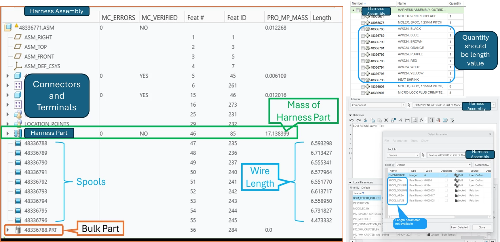

How to get the harness spool length parameter value into a WTPart or as a parameter value in Creo
We explored how to show wire details in a Wire Harness assembly by using the "Model Intent" option to designate wires and created standard Spool with WT Parts. By doing so, we were able to see wire details in the Harness assembly structure.
We want to show each wire’s length as a quantity attribute in the structure. The wire length appears in the model tree column, but we need to get the same value in the WT Part structure. How can we retrieve this value for the WT Part?
