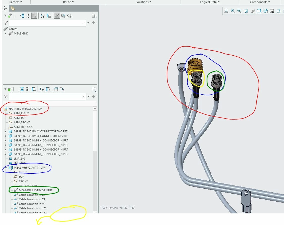

How to have Cable with different SPOOLs in a Harness
How to have Cable with different Spools in a Harness?
See Image attached. Green and Yellow need different spools. Spool option to change is grayed out for YELLOW. If changed for GREEN, Yellow also changes.
THANKS!
Lars_FAnswer
Apr 12, 2025 9:50 AM UTC
I believe that you just first create the spools you need. Do you have the necessary spools available? Each color cable must have it's own spool.
If you route manually then you can select the spool to be used when you route from - to...

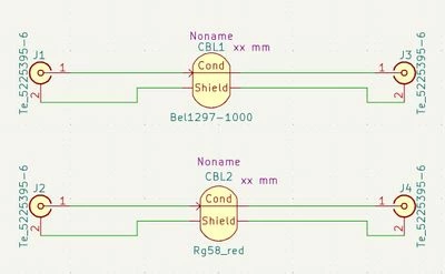

Cabling is much easier if you use Schematics to create the logical connections. The two spools are actual different components with thickness and color. The quantity is variable...
Br,
Lars

Yogesh.T
Yogesh.T14-AlexandriteAuthor
Apr 12, 2025 11:22 AM UTC
Hi, This is exactly I am stuck at. I cannot change my spool for the other two cables that follow the first one. I can change for the first, but it changes for all in the cables done in that Harness.
Yogesh
Apr 14, 2025 5:39 AM UTC

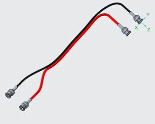

You probably have a different version of creo? Attached is the simple test assembly (Creo9) I used. Two Spools and two cables. I can't actually change the spool for any cable after it is routed. But if I first delete the cable then I can make a new cable with a different spool. In the sample below I deleted Cable1 and routed it again with a black spool... the new name is Cable3 (in component coax_test.prt).
If you use a logical file and you made changes to spools or connections then you have to use the "Update"-menu option until it shows that nothing to update anymore. I have noticed that many times I have to delete cables and spools before the "update" says that everything is OK (update-regen-delete-update-regen-delete).
Br, Lars
