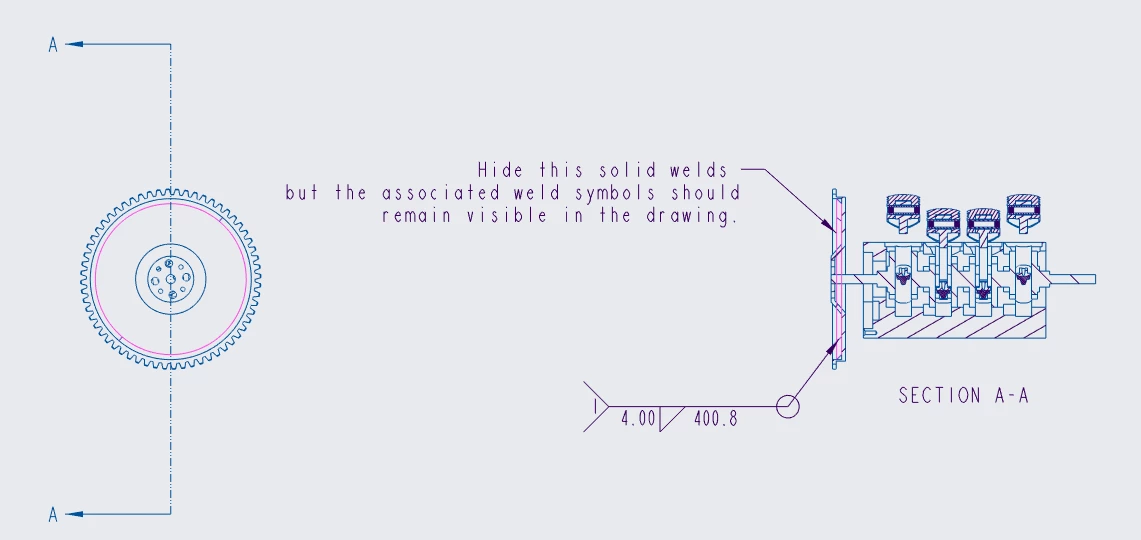

How to hide Solid welds without hiding associated weld symbols in drawings
I need to hide solid welds in a drawing while keeping the weld symbols visible.
Can this be controlled using layer settings?
Any guidance would be appreciated.

if you are not having trouble hiding the weld itself then just go to the show model annotations of the certain view and add the symbol , it well still show even if the certain feature is not visble ... i hope this helps 🙂

Under the Layout Tab, you can use Component Display to blank solid welds in your drawing view.
