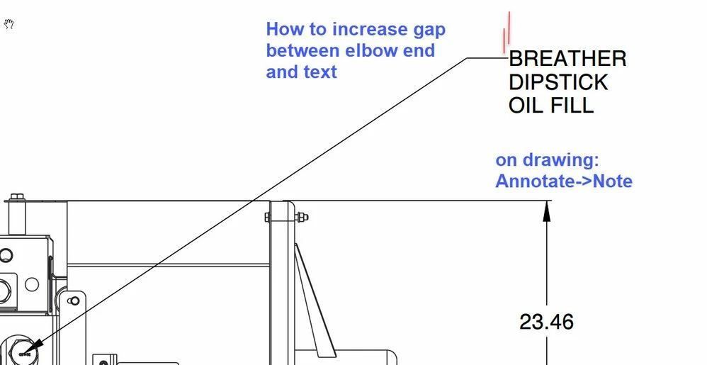

How to increase Gap between elbow end and the text in Annotation Note?
 any drawing properties to change in .dtl file?
7 replies
8-Gravel
Jun 21, 2023 5:42 PM UTC
I have the same issue here in June of 2023. Are there any answers for this yet? It appears as though the elbow of the note extends into the textbox of the note. It probably would look perfect if the note textbox was not transparent. Said another way, if the note textbox covered what was behind it, the elbow would be shorter and look right. Is there a setting for this?
My silly fix is to just press the space bar before I enter my note, but now all the notes have longer leaders than the regular dimensions.

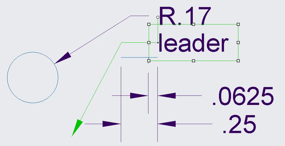

For the gap mentioned you can refer to my answer above, for the elbow length you can hold shift, click the dimension and then drag to increase or decrease the elbow length (see images below).
I found this solution in this thread: https://community.ptc.com/t5/3D-Part-Assembly-Design/elbow-length-drag-handles/m-p/214368/highlight/true#M43195
Conversely you can also set a default dimension for the elbow length by changing leader_elbow_length (see image below), for instructions on how to access the menu to change the value kindly refer to my answer above.

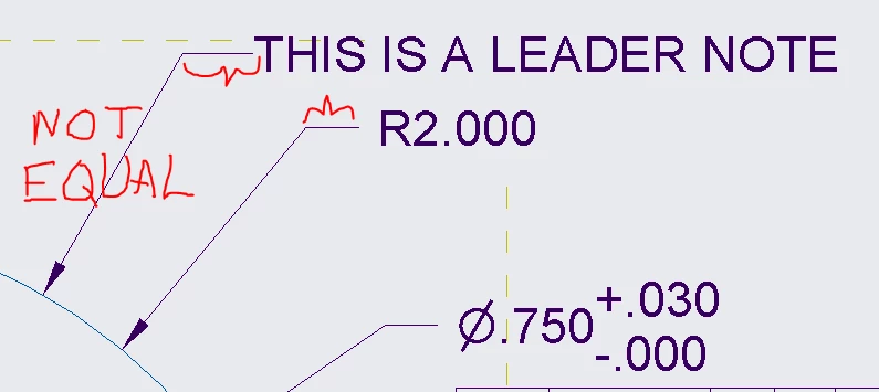

8-Gravel
Jun 30, 2023 11:22 PM UTC

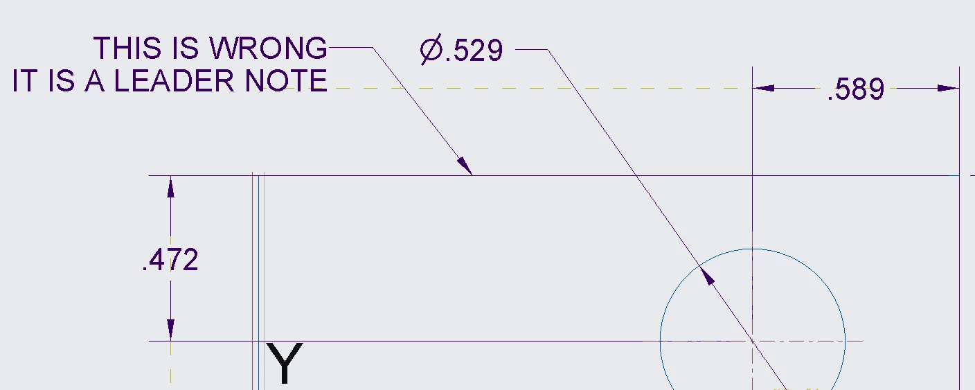

Those ideas work on dimensions. I have issues with Leader Notes on drawings. The leader_elbow_length does change the length of the leader elbow, but it is still "attached" to the note instead of producing a gap. The option dim_text_gap changes the gap between a dimension value and a dimension line or a dimension value and the elbow of a dimension, but it doesn't affect a Leader Note. Perhaps there is a setting that synchronizes notes and dimensions?

8-Gravel
Jan 11, 2025 7:21 PM UTC
Tried that setting and it modifies dimensions like radius, diameter, and linear dimensions, but it doesn't change Leader Notes. What's frustrating here is I have seen this working properly at another company. Seems like there is a special "hidden option" that if you know the magic word, you can edit a .dtl file with a text editor and put in the hidden option and a value to make this work. Alternatively, this could be controlled by an option that already exists but has an obscure name that isn't referenced anywhere. Something like "when the default view text height is non-zero, the gap between the text and elbows in leaders is no longer calculated." This is still a problem for me in Creo Parametric 10.0.5.0 on January 11, 2025, so it seems like no one else has this problem, or PTC is planning on fixing this problem right after they fix the Hole Table functionality. 😉 Leader text problem created with Creo 10.0.5.0Leader text problem created with Creo 10.0.5.0
