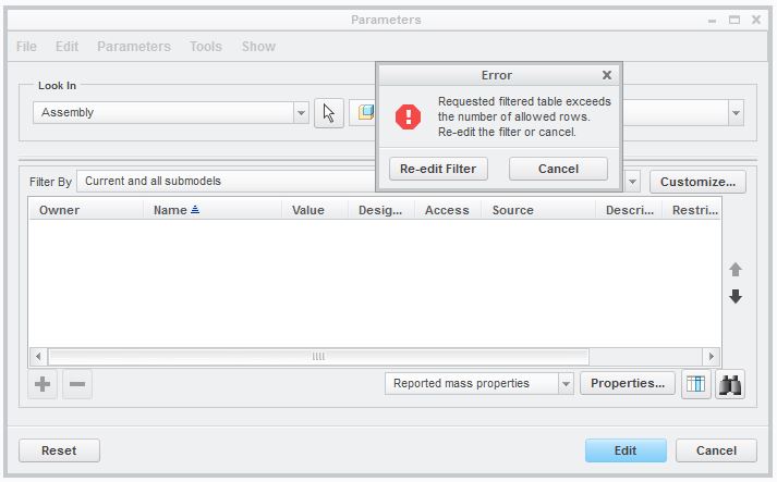

When requesting sublevels as filter in assembly parameters
I am getting this error message
What to do?
Essentially I only interested in exporting the PRO_MP_VOLUME - parameter of each and every part in this assembly.
Any alternative ideas?

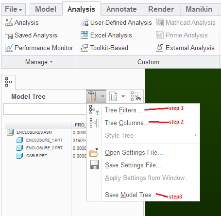

You can export the value of this parameter by exporting the contents of a customized model tree:
- step 1) show only assembly components in the model tree (uncheck from being displayed: features, placement folder, and all the rest)
- step 2) remove all columns and then add column for the model parameter "PRO_MP_VOLUME" (also listed in the type mass-properties parameters)
- step 3) export the contents of the model tree
athomasen1-VisitorAuthor
March 27, 2017
Thanks a lot!
