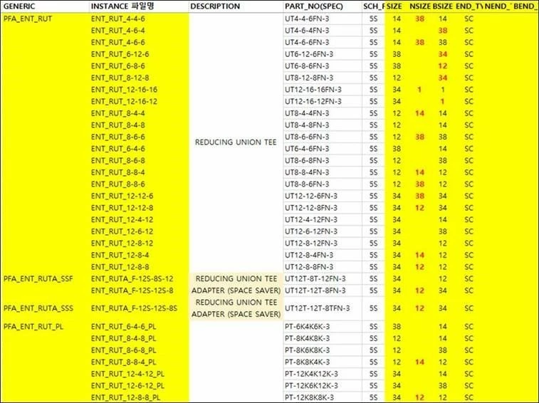

We want to use the Spec Driven piping module when they design. But The Spec Driven piping module have some problems.
For example,
  > Fittings in Spec Driven piping is also limited and some fitting are not supported
  • SIZE ≠ NEW_SIZE
  • SIZE ≠ NEW_SIZE ≠ BRANCH_SIZE
  • BRANCH_SIZE > SIZE = NEW_SIZE
It is possible when SIZE is larger than BRANCH_SIZE(SIZE > SIZE_ BRANCH) but the opposite is not possible as BRANCH_SIZE is larger than SIZE(BRANCH_SIZE > SIZE).
We use these fitting types (as below).
How to insert reducing tee? Please Let me know anything to do.
January 10, 2018
I had opened a case for this issue (C13908562) and it's a known issue (CS273955). Unfortunately, Creo Parametric can only support a single reducing tee where the branch is different. In other words, SIZE must always equal NSIZE; only the BSIZE can be different. This is a commonly requested issue, the PTC product manager is aware of this and has scheduled this enhancement for a future release of Creo Parametric.
