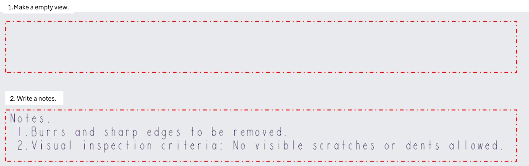

how to make a empty view box. 空のビューを作成したい。
  • July 16, 2026
  • 85 views
Creo Parametric 12.4.4.0
I want to the empty view because I write the notes. please teach me. how to make a empty view box.
Best answer by KenFarley
You do not use views to define notes on drawings. You just make a note, then move it around to where you want it. Views are used to show geometry.
