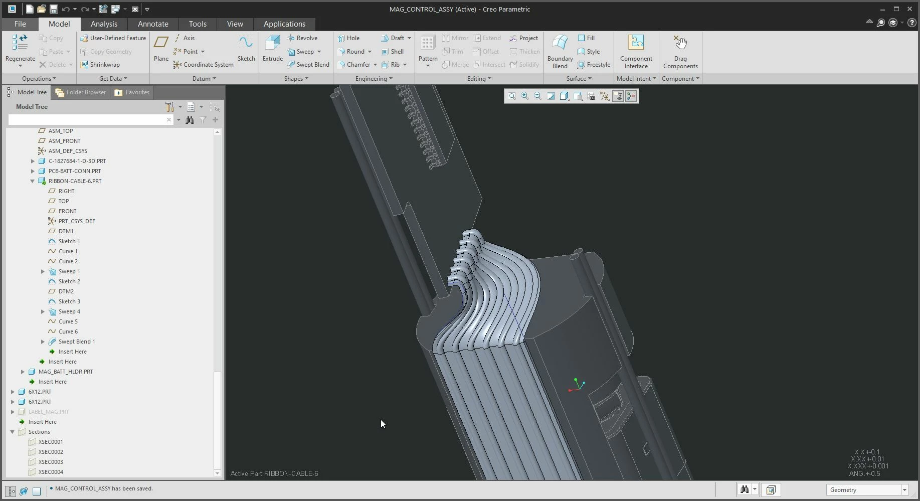

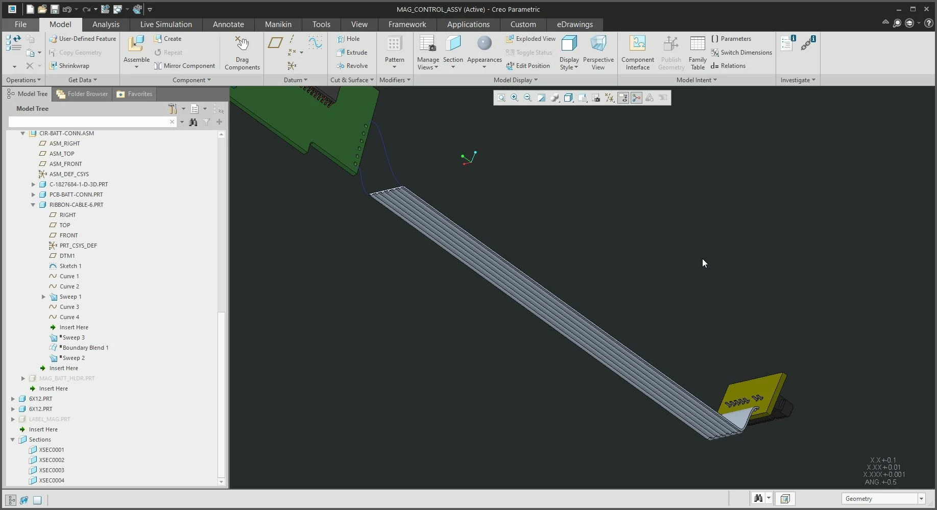

How to make a ribbon cable without cabling?
How does one make a ribbon cable part without the Cabling application. Simple turns are easy. How to do a twist?
tbraxton
tbraxtonAnswer
Define the trajectory for the cable to follow first. make sure that is valid geometry to be used as a sweep trajectory. For a twist of the cable you should be able to do it with one trajectory and a variable section sweep.
https://support.ptc.com/help/creo/creo_pma/r9.0/usascii/index.html#page/part_modeling/part_modeling/Rules_for_Defining_a_Trajectory.html#
Use a variable section sweep to create the "cable" section and clock it by using Trajpar with relations in the sketch or driven by a graph as @Constantin has proposed above. This will vary the angle of the sketch along the trajectory.
https://support.ptc.com/help/creo/creo_pma/r9.0/usascii/index.html#page/part_modeling/part_modeling/About_the_Trajpar_Parameter.html#
You will probably find it easier to model the twist transition solid geometry separately. Using this approach, it makes the control of the variable sweep  less complex than trying to use a single sweep for the entire length of the cable.

BillR8-GravelAuthor
8-Gravel
tbraxton: The Swept Blend (variable section sweep in Proe-speak?) helped. It is not perfect (see attachment). The twist if flattening out the round bumps for the wires.
Constantin: Not sure how to implement trajpar within regular Sweep.
tbraxton
It appears that the twist trajectory portion does not capture the minimum bend radius causing the distortion at the transition.
Trajpar is only available with a variable section sweep.
Patriot_1776
I've done this, but a lot more complicated a path (had to avoid geometry and go thru slots in PCBA's).  PITA but rewarding when it's done.  The problem is several fold, first, it's basically impossible to make sure that the lengths of the individual wires in the cable are equal like they would be in real life.  Then, you can twist the line of sketched circles of your sweep section, but, say, if your trajectory is in the center of the line of these circles (as it should be), as the section twists, the circular sections NOT exactly centered on the trajectory will distort and become oval, the further out from the trajectory, the worse it gets.  So, you have to solve that problem, the bigger of the 2 IMO.  Think about how you would do that.  I didn't worry about the "equal length" issue as there really is no good solution I found for that that wasn't absurdly complicated.  I did this back in 2008 in Wildfire.
