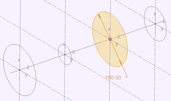

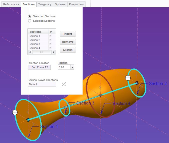

Start with a sketch made of multiple lines, arcs or curves.
In the sections tab of the swept blend, sketch the starting section.  Select the insert button to add a section at the end and select the Sketch button to create the section.  Selecting the Insert button a third time to place a third section.  To locate the section pick the end point of a line within the section and select sketch to create the section.  You can only have as many section as you have line end points.
The sections will be normal to the curve at the selected point.  If you use a multiple line section, such as a square, you control the twist of the sweep by selecting the endpoint in each section that you want to be connected and select Start Point from the right click menu.

The trajectory can not be placed within the sweep or swept blend, as of CREO 2.0.  A section can be place at each line/curve end within the swept blend by creating a section at both ends and selecting internal nodes for additional sketches between.
