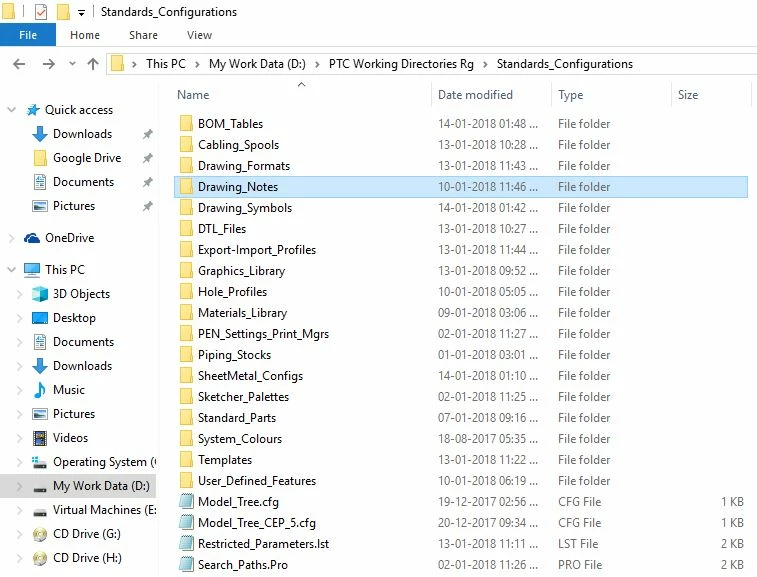

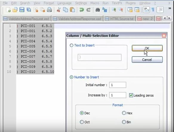

Maybe I'm a little late to reply, but here are my suggestions.
Formatting for Numbered Lists:
Rather than using simple Notepad to create/edit text files, use Notepad++ which can give you numbered lists.
Bullets-and-Numbering-in-Notepad++
Notepad++ Column Editor Trick

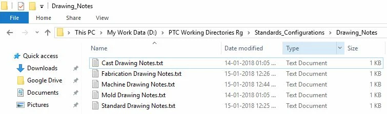

Managing Multiple Notes for Different types of Drawings/Customers:
Add a Config.Pro option pro_note_dir mapping to the folder having notes for different types of drawings/customers. [Refer Images below]
Addition/Deletion of Notes:
Create a temporary new Text file with all required notes and edit using Notepad++ and save it then import using Note from file in Creo.
This might not help you 100%, But I think it can take you halfway through.
