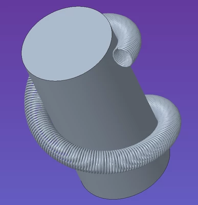

I am drawing a blank on how to model a coiled extension spring.  The simplest example would be an extension spring wrapped around a cylinder.  Any suggestions?  I am currently on CREO 7.

I can do a regular spring.  I want to model the spring wrapped around a cylinder.  A spring coiled up.

I'm moving to 10 in the next couple of weeks if you want to send the model, but it sounds like your spring is just a regular straight spring.  I want the spring wrapped around a cylinder; coiled up.

Something like this:
Creo 7 attached.

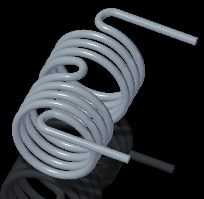

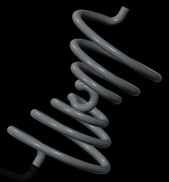

That's certainly not what I would have thought of as a coiled extension spring.  I think if you would have included a photograph or sketch it would have helped people help you.
Patriot_1776
January 10, 2024
For a "coiled extension spring" I would have expeced the need to be something more like these:
