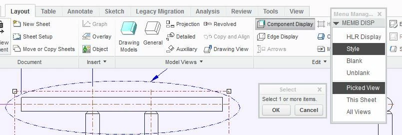

July 24, 2017
For hiding only a few components try using Componet Display instead of Simplified Reps.  This will eliminate the repeat region BOM Baloons issues between views of different simplified reps.  Capture.JPG
Sub assemblies can be querry selected.
