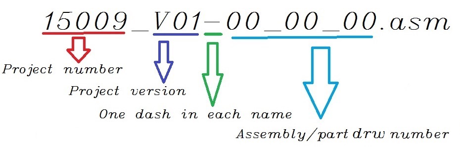

October 13, 2016
Yes MartinHanak is 100% correct.
Base technique is in file naming scheme.
Using exactly same file name in many directories will get you mad in future. --- DON´T DO IT!!!
For example try following:
Due this shema you can use the same 3Dmodel with different file name in many directories.

"Due this shema you can use the same 3Dmodel with different file name in many directories." - asking for TROUBLE!!!!!
If you have common files, isolate them in a common folder area, not project specific.
It sounds like you need a PDM system to track and manager your files, so you only have 1 file of 1 model and the system keeps track of where it is and the latest version.
