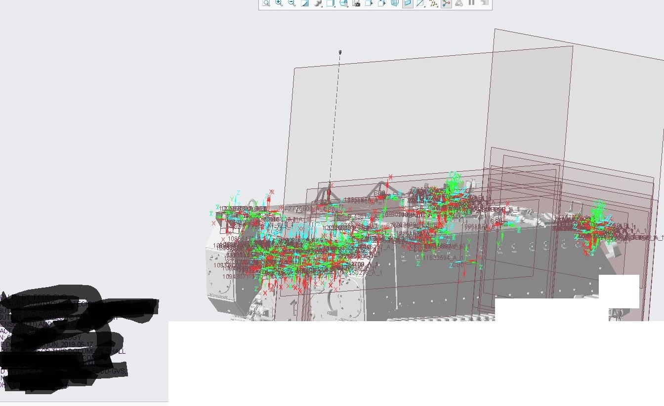

How to open my big assembly in Creo10 clean, without Datum Display Filters on.
When I open a big assembly, is there a way to open it clean without showing all points, datums, axis, coordinates ? See attach

You can go to the options and turn off the datums, points, csys, axis and save the config so every time you open creo, all the displays are "off" by default.
This display is a system setting, not just for a single assembly. They are either on or off.
The way you handle them in specific files is to set up layers, add the items you need to control and hide the layers that has the items you don't want to see.

Hey Stephen,
What option on config is that. I tried datum_display and nothing pops up in find. OR am I missing something? How to do that?

Hi Yogesh,
I think that the configuration options you need are:
display_axes no
display_planes no
display_points no
display_coord_sys no
