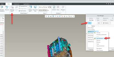

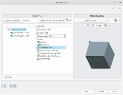

How to open this editor
I want to know how to open this editor
it is about Automatic Representations ( ver. CREO 9.0 )
StephenW
StephenWAnswer
Mar 10, 2023 11:22 AM UTC
go to the view tab, select the view manager, select Simp Rep from the pop up. Then you will either create a new Rep or RMB edit definition on an existing Rep
