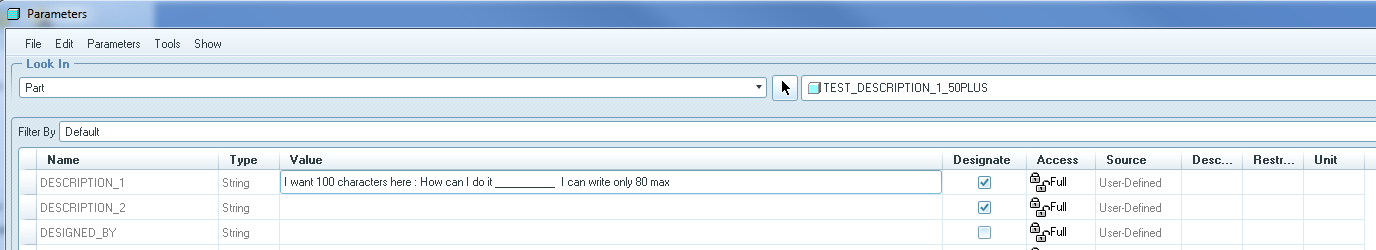

HI everyone,
It is possible to pass over the 80 Character Barrier for String Parameters? I'm trying to write in a custom parameter more than 80 character, I'm not able because the field does not accept more than 80 characters.
I'm using Creo/Pro 5.0 M220.
Thanks for your help!

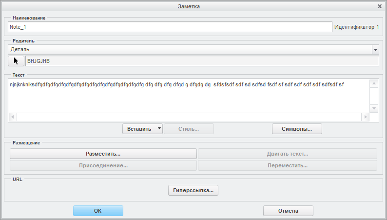

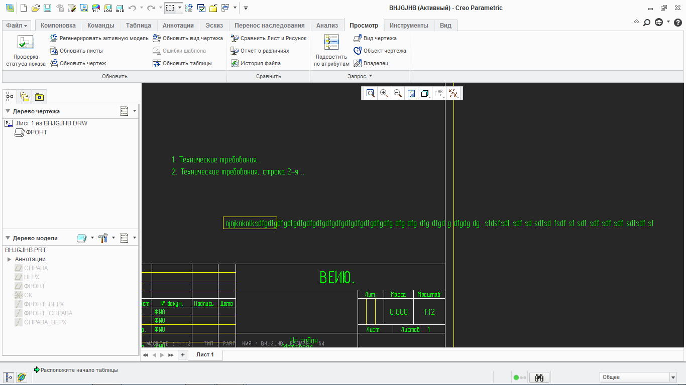

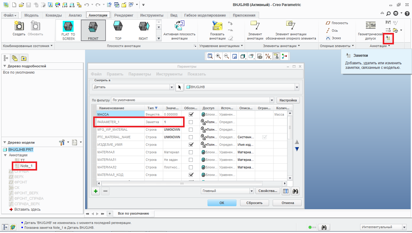

Hello Chantal Gagne here is another way (sorry for my english)
1. Create Note_1
2. Type text to the new note like this
3. Create PARAMETER_1 and choose type "note" and value "note_1 id" (see in the picture above in the right top corner)
4. In the drawing you can report your PARAMETER_1 value

April 1, 2014
I tested the solution proposed by Pavel Burtsev actually works well. But my parameter is mapped into Windchill and nothing appears in Windchill. I even changed the configurations of Windchill to accept 100 characters from this parameter and it still does not work.
