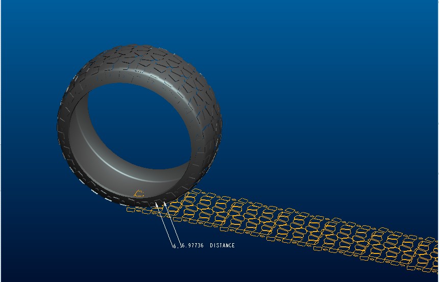

Hello, everyone, how the flat pattern as shown in the paste on the surface of the tire?
Requirements: the size can not be changed,
So can not use the normal projection
Will you have any good suggestions?
I heard that the envelope can be achieved, but do not know exactly how to operate, please advise
thank you in advance

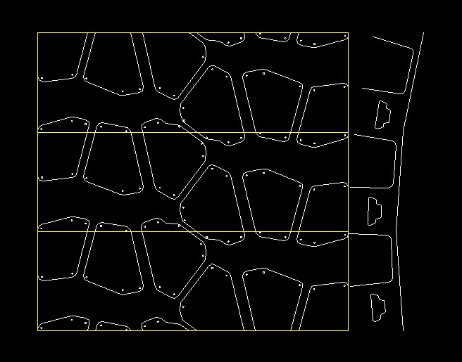

If i understand your question correctly, one method you could try is first make a flat feature of your tire, that is, you make a rectangle, then create a fill pattern of the feature you would like pattern on the tire. Lastly, you create a 360 toroidal bend using a cross section of the tire profile. Toroidal bend example.jpg

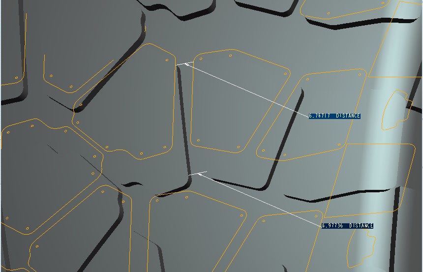

I also tried this method, very simple to operate, but do not know you find this question: bending will change the original size.
See Figure:
Wireframe on the size of the original size, on the entity's size is the size after bending between them is not changed it?
This is not permitted.
May I ask a more appropriate way?
Thanks again for your help.
Best Regards
Shuni

I am bit unsure how to pattern this feature without the size changing. One other option you could try is to create the pattern on a separate flat surface, and then save this a picture / color to be rendered onto the surface of the tire.. hope this helps..
