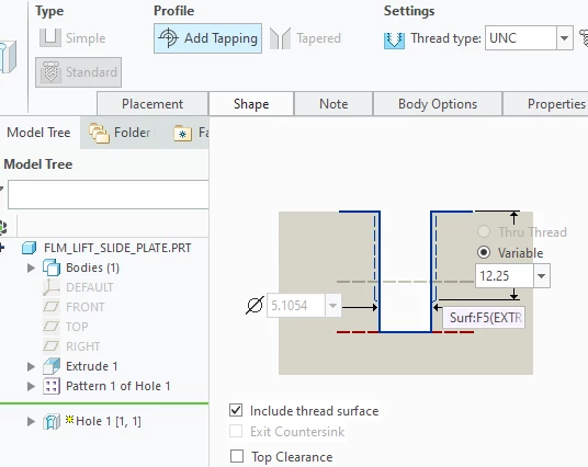

Would anyone know how to prevent Creo 10 from creating cap surfaces for tapped holes while using the Creo Parametric Hole feature?
The surface shown in the image below is not the side wall of the thread but a cap surface at the top of the thread.  This makes you have to query select the hole which is an extra step when assembling parts to the tapped hole at the top-level assembly.

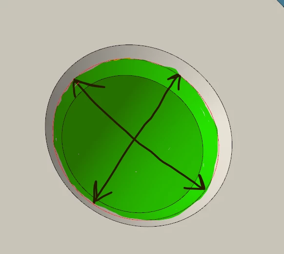

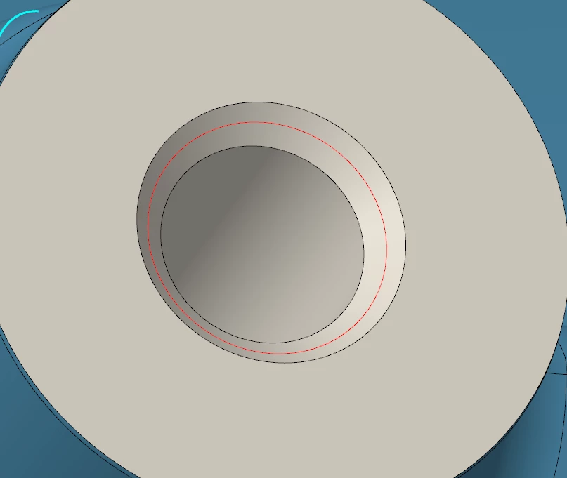

“Cap surface”, you mean a countersink at the entrance?
7-Bedrock
Apr 21, 2026 7:03 PM UTC
The cap surface resides about halfway down the counter sink entrance as shown in the image below.
kdirth
Apr 21, 2026 8:10 PM UTC
That is an open cylindrical surface created to represent threads.  You can turn it off at hole creation.  Turn off add tapping button.
