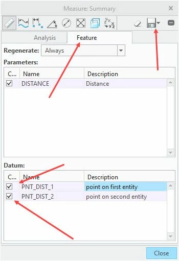

A different normal can be for each and every point on the surface. You may be able to get what you want by going to Analysis tab, measure, select the point and the surface, in the analysis dialog, box, select feature, then checkbox the datum points for both positions, and SAVE in the analysis box, you can accept the default name.

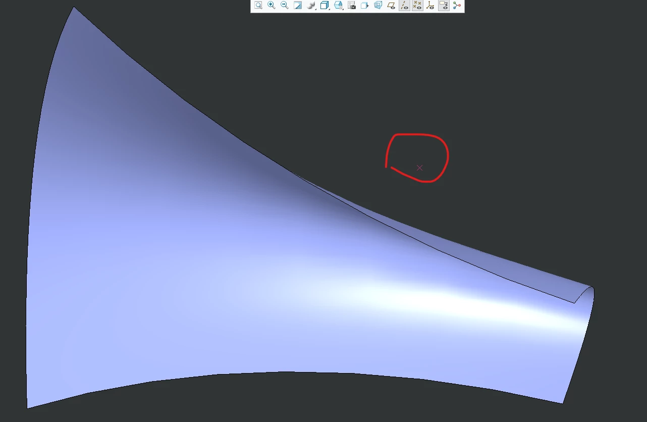

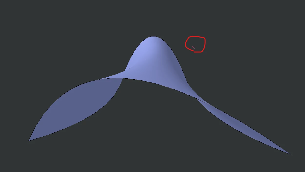

rcaetano1-VisitorAuthor
May 5, 2020
It is not clear for me what you said. For instance I would like to project datum point highlighted on picture below onto surface. How can I do this?
