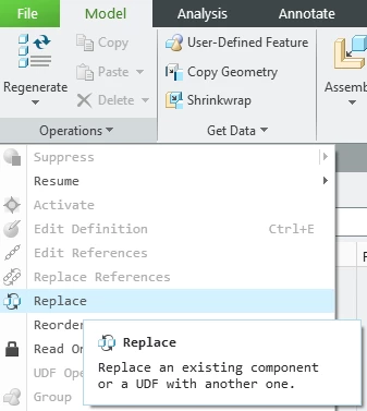

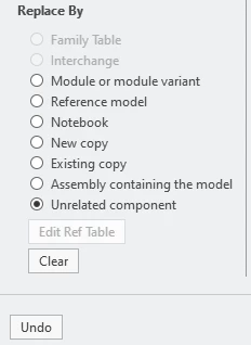

Well, how did you replace the component ?
Assuming you deleted a component and brought in its replacement - then now you can only delete the broken offset line and create a new one...
Next time, try using the "replace with unrelated + Edit Ref Table" method - then the offset line will (probably) be preserved.
