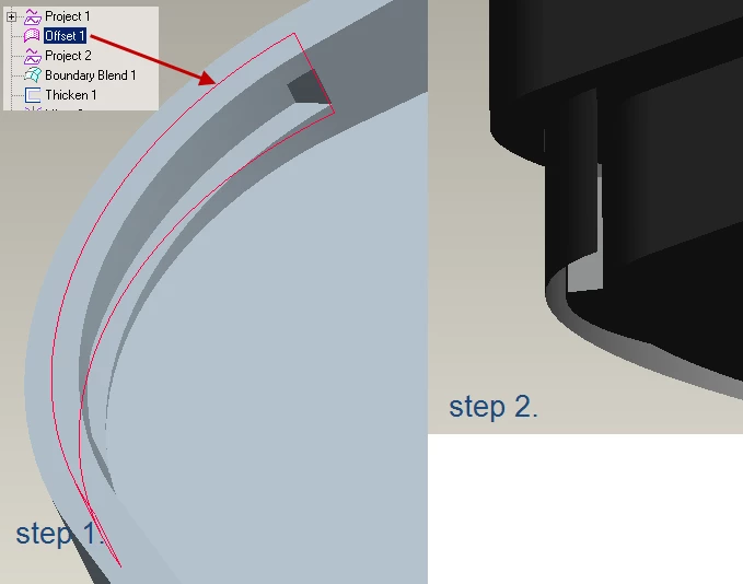

how to remove a created surface
wildfire 3.0
I created an offset surface (Offset 1) so that a can make a recessed cut in a part (thicken cut) up to Offset 1 (step 1.). After making this recessed cut, is there a way to remove Offset 1? The offset surface is appearing in a 2nd part after performing a Cut Out feature (step 2.). Hiding Offset 1 in the 1st part does not seem to get rid of the surface appearing in 2nd part.
December 2, 2011
Layers, my friend....
