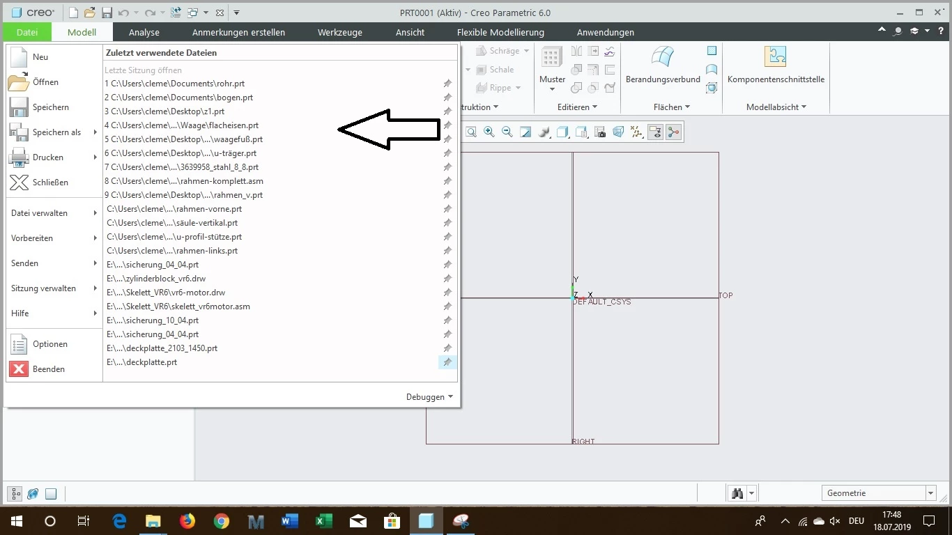

How to remove last used files? Clearing the list of it
another one from for this day.
I want to clear the list of last opened files on the left panel. I googled but havent found smthg to solve this. I add a picture so can see what i mean by that.

This is something which is controlled by system registry not by application. You may try google to clear recent files without specifying the application.... As far as I remember it use to be in HKEY_CURRENT_USER.. but editing registry should always be done by IT...

7-Bedrock
July 21, 2019
Are there any other possible solutions? Because nearly every other software has this option to clear the list of last used objects and not by changing something in registry?

There is no direct option to "clear" the file history. This can be a good Idea to add option to clear list. One of the other options, config option visible_recent_file may help you...
You can set this option to a number to display file in list.
