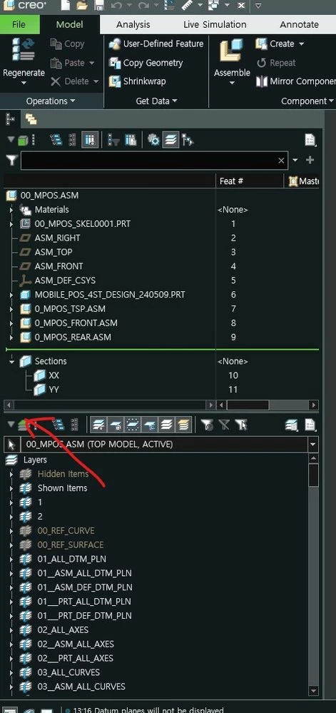

how to remove layer tree?
Hi this is YJ
I'm using the creo 11 these day. every-things is better than creo 9.
but i got problem on layer tree.
when i open the data i can see the layer tree every time.
even if I turn it off or change min size this. it come up on my screen every time.

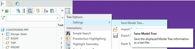

After closing the layer tree you need to save a tree settings file.
Select the Model Tree Settings icon, then Settings and Save Model Tree.

Thanks for reply.
i did as you said. save a tree setting and close creo program.
but still i can see the lay tree on new creo. how about your croe?
is it program burg?
yongjoo3-NewcomerAuthor
3-Newcomer
Aug 1, 2024 1:52 AM UTC
i found the problem.. my config file was wrong.
i used the configuration from creo ver 7.
so i removed the tree comand  and the problem was solved.
The problem was mine.
