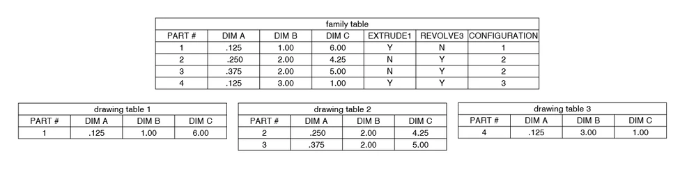

I have a family tabled part that I need to create multiple drawing tables from and each table will represent a different configuration of a part file (some features excluded, some not).
Based on a parameter called "configuration" and its value I want to exclude rows that are not related to a particular configuration. See the image below of the family table and 3 tables that I want to create from the family table.
How can I filter a simple repeat region to not include data related to an instance that belongs to a type of configuration?
How can I filter a 2d repeat region to not include data related to an instance that belongs to a type of configuration?

I think 2D repeat region is not the right way. Even simple repeat region containing fam items is not the right way.
It seems to me that the only solution is the following one:
  • create an auxiliary assembly containing all the family table instances
  • add the assembly into drawing as additional drawing model
  • set the assembly as active drawing model
  • create repeat region showing assembly components
  • set filter to display specific family table instances
See uploaded drawing.
