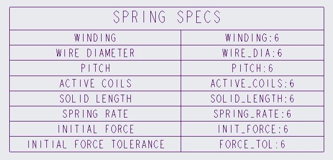

I have a small problem with a drawing that I have been working on. I am using a table to call out some spring specs by calling out the parameter directly. All of our springs are controlled by a family table so the idea was to create a drawing where you could "Replace View Model" and instantly have a drawing that has all the info for the new part. The problem is the table wont update because the parameters are all followed by a session ID that still links to the old model that was replaced. If I manually remove the session ID from the parameter the table will update.
Is there a way to automatically update the session ID to the ID of the new model?

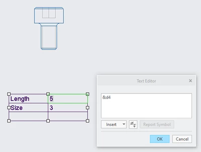

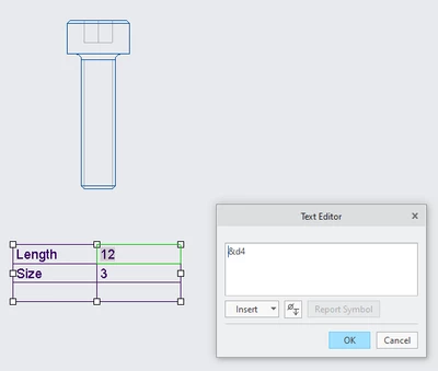

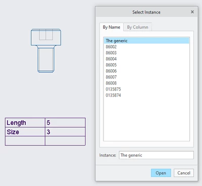

Is this drawing of a single part of of an assembly?  Does the drawing have multiple models added to it or does it contain only a single model?
Single model part drawings do not require session ID in the tables.  The dimension name can be directly referenced and will automatically update when the drawing model is replaced with a different family table instance.
