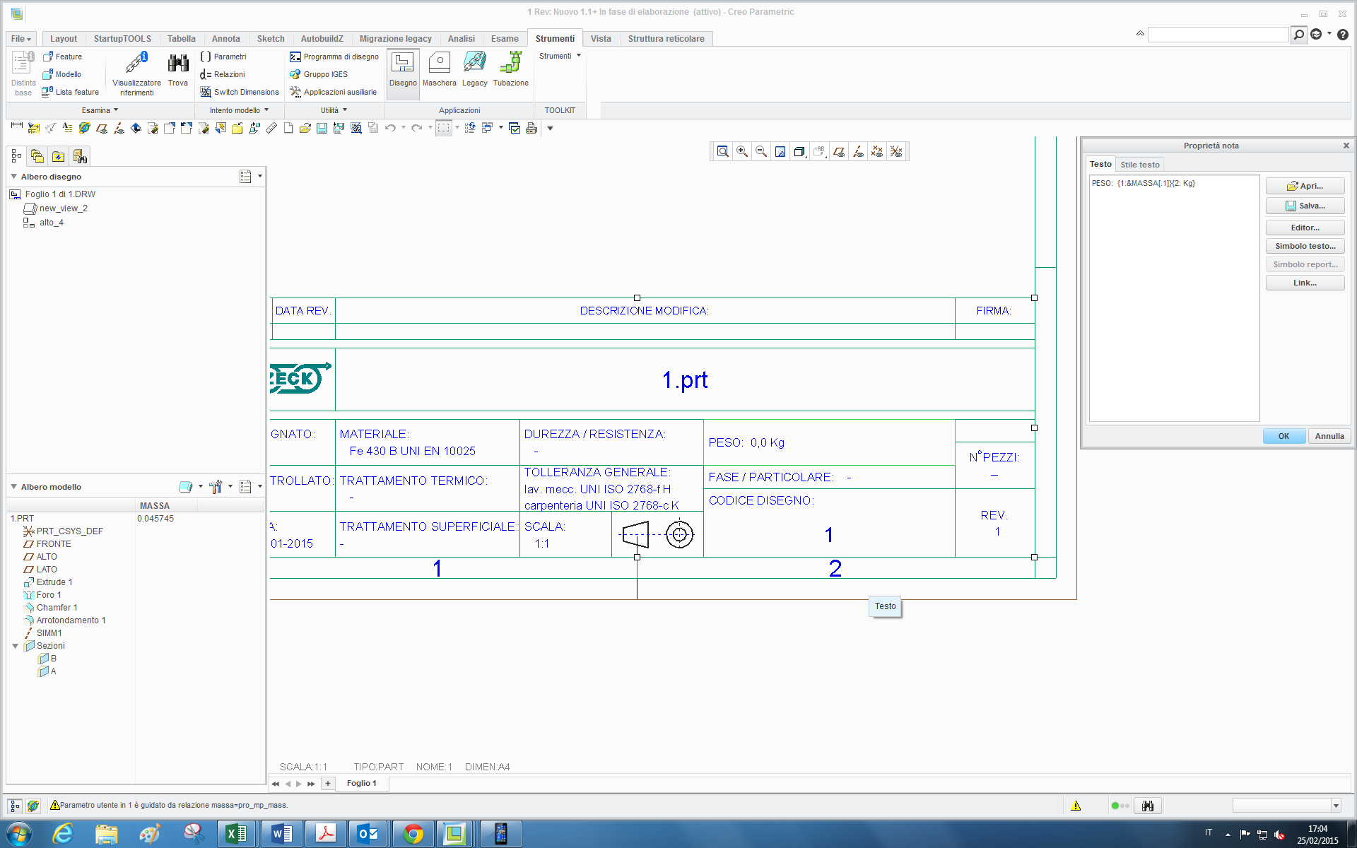

I am experiencing a problem with reporting a number parameter (in my case a parameter of mass) with specific decimal places in a drawing.:
- I would like to plot the parameter with 1 decimal places if the mass is higher or equal to 1 kg.
- If instead the mass is lower than 1 kg, I would like to report it with 2 decimal places
I tried to set a conditional script (in the relations field) with functions like "if...ceil(),floor()" : but the problem is that in the drawing cell where I report the mass, I cannot set a conditional-formatted number of decimal places. I can set only 1 or 2, fixed:
and therefore when the mass is higher than 1 kg (for example 2,6 kg) and I set 2 decimal places in the cell property window, it reports for example 2.60 kg (with a useless zero).
(and vice-versa if I set 1 dec. place with a mass lower than 1 kg, the system cuts out a decimal place).
thanks

The only way I know to do this is to create a single cell repeat region, add the appropriate relations to convert the mass to text, and then manipulate accordingly.
The repeat region parameter will initially be set to &mdl.param.value and a "by rule" filter will need to be added for your specific mass parameter. Something like &mdl.param.name == massa. This should display only the value for the mass in the repeat region. Next, add relations to the repeat region:

Hey, I do a lot of this type of stuff for building part numbers, descriptions and the like using dimensions. This is the slightly more tricky way I have to get floating point numbers into text strings, with decimal places the way you want them:
IF FLOOR ( number ) < 1
WEIGHT = "0," + EXTRACT ( ITOS ( 100 * ( number + 1 ), 2, 2 )
ELSE
WEIGHT = ITOS ( number ) + "," + EXTRACT ( ITOS ( 10 * number ), 2, 1 )
ENDIF
The addition of 1 to "number" in the first IF clause ensures that multiplying it by 100 gets a number of the format 1XX, so extraction of the two digits of interest is guaranteed.

I inserted this script (massa_disegno is the parameter to print in the drawing):
if pro_mp_mass<1 & pro_mp_mass >= 0.0005
massa_disegno=itos(1000*pro_mp_mass) + " g"
else
if pro_mp_mass-floor(pro_mp_mass) < 0.05
massa_disegno=itos(floor(pro_mp_mass)) + ",0" + " kg"
endif
if pro_mp_mass-floor(pro_mp_mass) >= 0.95
massa_disegno=itos(ceil(pro_mp_mass)) + ",0" + " kg"
else
massa_disegno=itos(floor(pro_mp_mass)) + ","+ itos(10*(pro_mp_mass-floor(pro_mp_mass))) + " kg"
endif
if pro_mp_mass < 0.0005
massa_disegno="< 1 g"
endif
endif
Therefore at the end we decided to print the mass with this logic:
- part with mass lower than 1 g as --> " < 1 g"
- part with mass lower than 1 kg but higher than 1 gram as --> " xxx g "
- part with mass higher than 1 kg as --> " xxx,x kg "
and the script works!!
and...yes it's incredible how Creo is missing a function like this too, and above all there is no possibility to use "else if" so I have to make strange nestings!!
