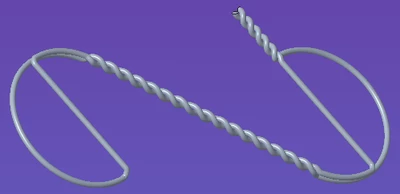

kdirth
March 30, 2021
I would suggest you carefully lay out a path and create curves to sweep.  If it is dimensioned well you can use flexibility modify a single model to fit many configurations (different spacing, different head sizes, etc.)
kdirth
March 31, 2021
Something like this.  You could also leave out the sweep and only show the final curve.
kdirth
April 6, 2021
Here is an improved version in 4.0 with predefined flexibility.

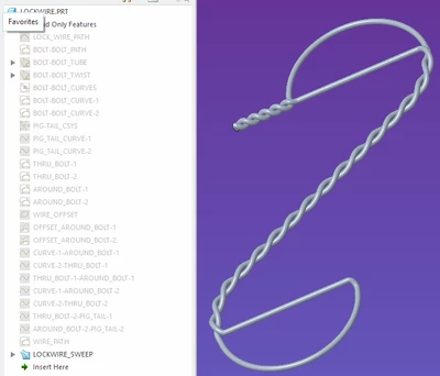

KenFarley
March 31, 2021
We use locking wire to prevent fasteners from backing out on a number of assemblies, where two fasteners are somewhat adjacent to each other. We don't model the locking wire for every assembly at present. What was being done was designers were using images of a wire lock, pasting them into their drawings. I found this to be pretty ugly, because they were using photos from catalogs, so the "white" background of the images didn't match and you got a gray rectangle, etc.
To get rid of this I modeled an "example" model of the wire loop; an assembly that shows two representative screws with the twisted wire between them. The difficult thing, as you know, was modeling the wire. I did that by building a set of curves:
(1) Two simple flat curves that lie along the center of the "end loops", the bits that go through the fastener holes.
(2) Two twisting curves that define the twisted wires that connect the two end loops.
The "trick" for doing this was defining the twisted curves. For the wire to look right, the curve has to start off and end off tangent to the end loops. The only way I could come up with to do this was to sketch a graph that starts and ends with horizontal lines, and use the evalgraph() function to drive the twist. It's too complicated to describe simply here, but it works like a charm.
I'd imagine if I put a bit more effort into it, I could make that model more generic and useful for different situations (variable length, angle of holes in bolt heads, number of twists, etc.) Perhaps, when I have some time...

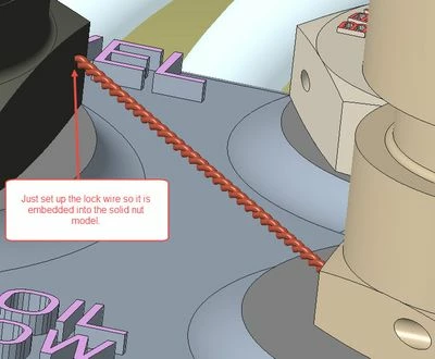

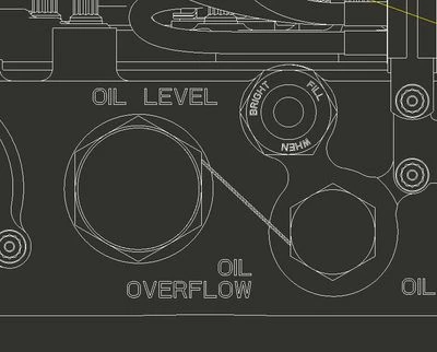

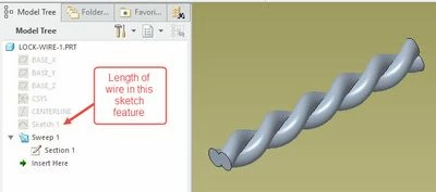

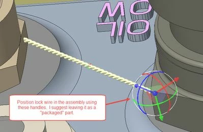

Airfix10-MarbleAuthor
March 31, 2021
What I ended up doing was just creating a single part made from 2 features.  A trajectory curve and a sweep.  It's just straight.  I used the trajpar function to create the twist.
Because they are straight and it is very difficult to assembly I'm planning just to embed them into the nuts (not necessarily through the holes).  They will remain packaged parts in the assembly and will be positioned approximately with the drag handles on the amble component command.
When assembled it is made flexible so that the length can be varied as needed.  I made a relation to relate the number of twists to the length so no matter what flex length someone chooses it will still look the same.
I might evolve it to something more sophisticated  that has elevation changes and curves and an easy way to assemble without being packaged.  It get's exponentially more complicated the more features you add.
