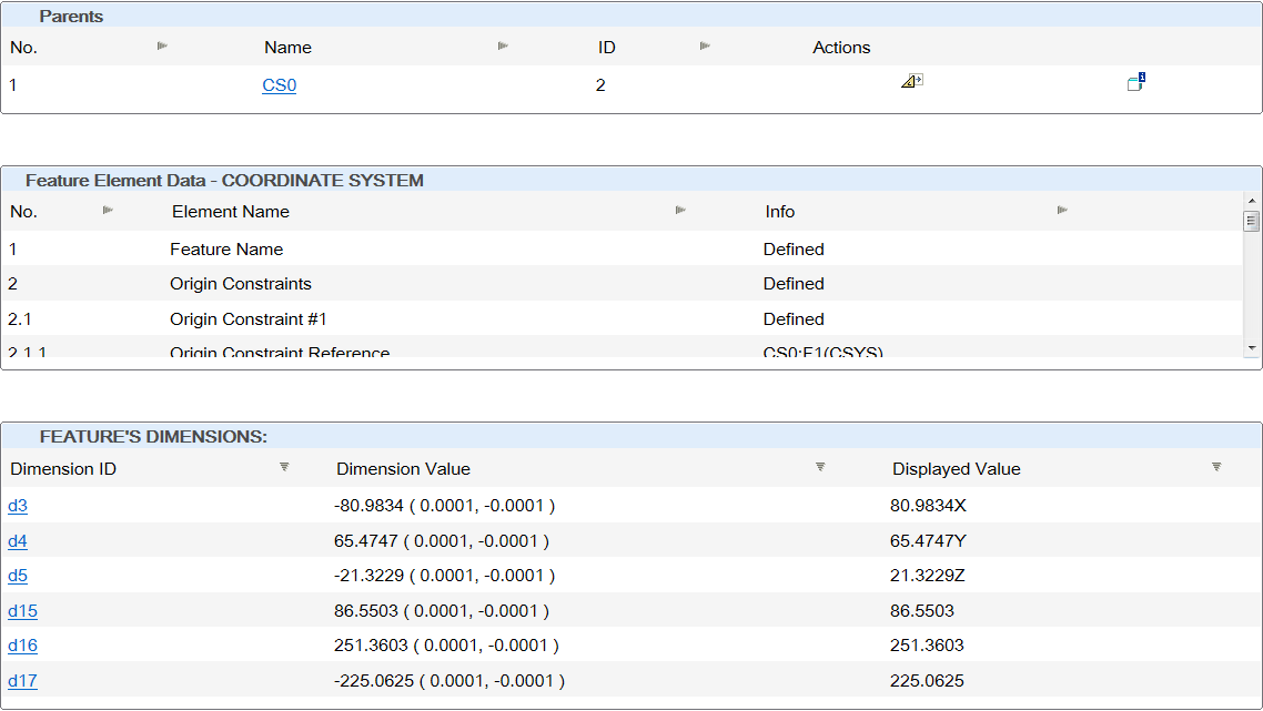

Jan 24, 2014 8:52 PM UTC
You can gather the information on the coordinate system. The info window has the designated dimension values.
More detail and the data is provided in the middle data on the UI if you scroll it.CSINFO.PNG
Remember that the CSYS can have spherical or cylindrical coordinates. Not sure if this affect the stored information.

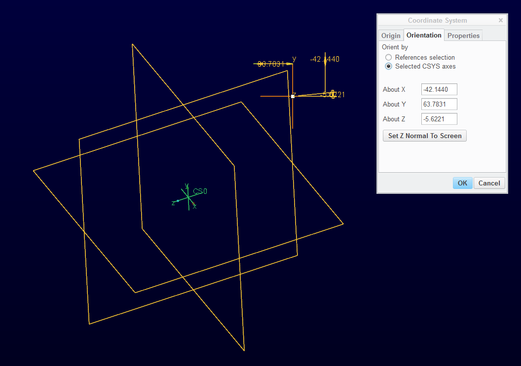

Jeroen1-VisitorAuthor
Jan 27, 2014 8:57 AM UTC
Thanks both.
The way I first tried it, is based on Antonius' post: Create a new CSYS (1) on top of the one you would like to get the information from, and in the orientation tab, select "orient by selected CSYS axes". Here you select the reference CSYS.
Afterwards, create feature relations (2) for this new CSYS to read the 6 location parameters, and put them in feature parameters.
These parameters I can use to create a new CSYS (3) directly referenced to the base CSYS.
This works, but if I change anything in the chain that alters the position of the measured CSYS, the new CSYS in step (1) would not update. I really need to have this to update.
The method based on Erics' post seems to be better in a way that this solution would update if something would change and the position of the first CSYS alters. But it's not clear to me how to transform the 4x3 transformation matrix into useful parameters to create my new CSYS.
Any thoughts?

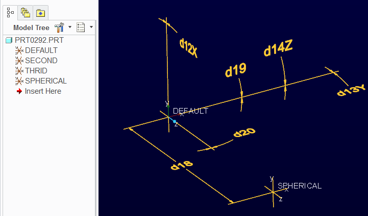

Jan 27, 2014 9:43 AM UTC
Okay, happily I am wrong about the interpolation. A CSYS defined by spherical coordinates from the default CSYS will maintain a radius (linear) and 2 angles for location, and 3 angles for orientation at the new location.
D18, 19 and 20 are the location, and 12,13, 14 labeled X, Y, and Z are the orientation angle in relation to the default.
Of course, cylindrical will be linear values for radius and Z values and angle for location.
