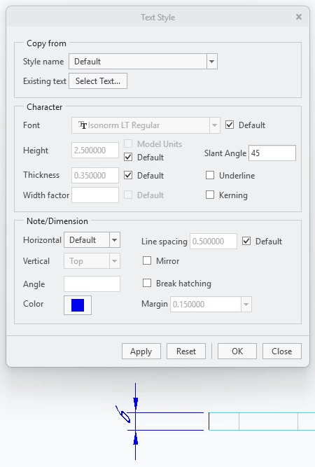

How to rotate dimension text
Is there a way to rotate the dimension text by 180°?
This is what I mean:
Old:
Rotated 180°:
I saw someone suggest to rotate the view 180° in a previous post but this does not work for me.
We are currently working with Creo 10.
Kind regards,
Jaime

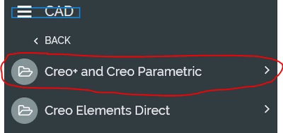

You are in the wrong forum.
PTC has two CAD systems:    Creo+ and Creo Parametric    and     Creo Elements Direct.
Which makes it confusing.
More, for Creo Elements Direct:
- The 3D software name is Modeling, and
- The 2D software name is Drafting.
For Creo+ and Creo Parametric, use only this tab:
You should move your post to this community to have a better chance to get an answer.
To move your post, click on the three vertical dots on your initial post and click on "Notify Moderator".

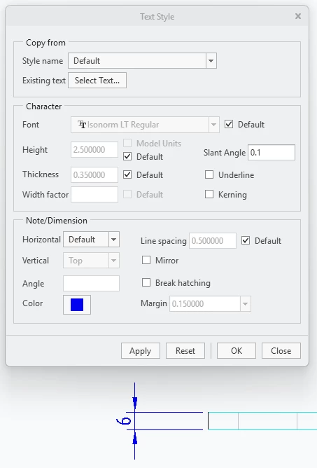

Aug 14, 2025 9:59 AM UTC
i think it is not possible by config or dtl options.
The only way if the dimension line not vertical but a little bit slanted counterclockwise for example 0.1 degree
Then dimension text will be oriented automatically as you want
vonGarlic3-NewcomerAuthor
3-Newcomer
Aug 14, 2025 11:49 AM UTC
I tried the following based on your suggestion, but I don't get the solution I'm looking for.
Perhaps I'm doing something wrong, so below some images to show what I tried.
Is this what you meant?
Kind regards,
Jaime

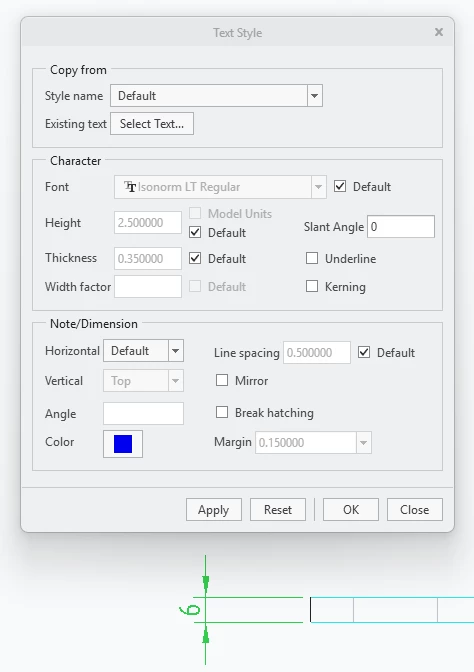

Van_AG
Aug 14, 2025 12:45 PM UTC
Please see the attached video
I meant dimension line slant, not dimension text slant
