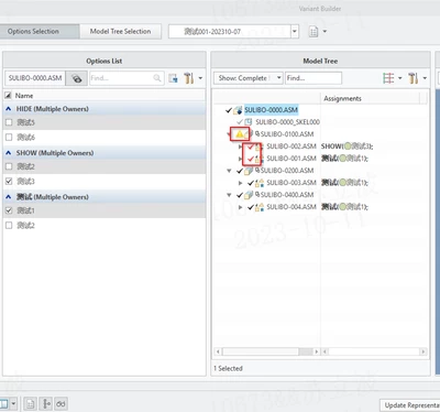

How to select multiple options from one module model?
As the topic, How to select multiple options from one module model?
This problem we meet in this kind of situation:
A customer wants buy  two options in one proect(one for spare compents);
And this image show the problme : Creo knows I want select these two options,
there is an alert incon(I dont know how to get the waring text):

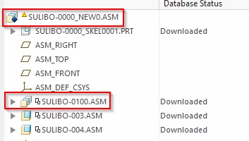

And after I click "Create Product Variant" , the reslut is not a normal assembly 3D model, but is a new  configurable product like this:
Would anybody knows: where the mistake I made, and how to correct it that make Creo generate a normal  assembly model with two options.
