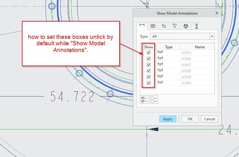

How to set all the dimensions untick by default while showing "Show model Annotation"?
Hi All,
 Whenever I click on "Show model annotation" on a sketch, I find that all the dimensions are selected by default (See attached screenshot). I have to untick each time. Is there any way so that we can keep the boxes untick by default? I would appreciate your help with this.

Set the config.pro option
show_preview_default remove
