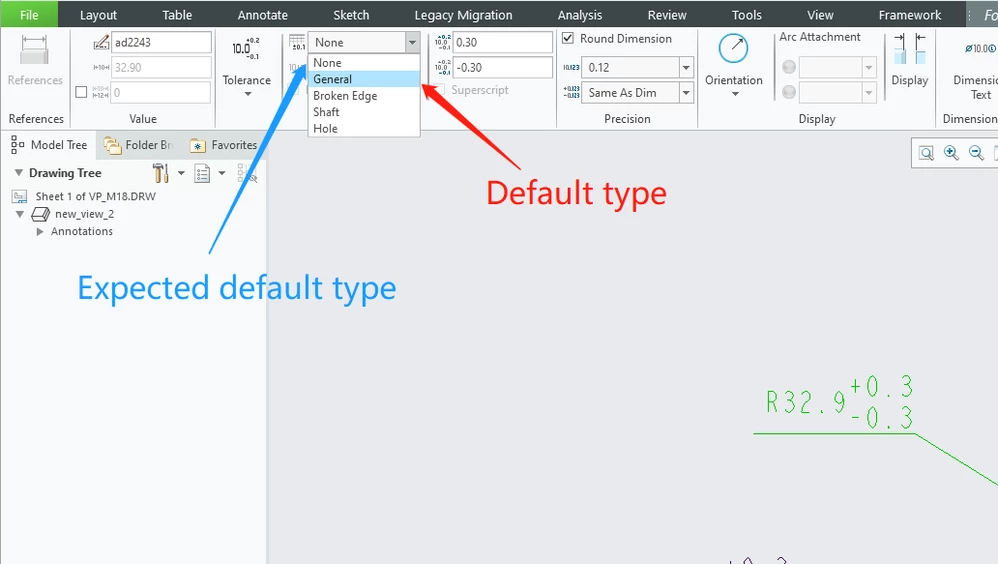

How to set the type of ISO tolerance table as none by default?
Hi there,
    Every time I set a tolerance, I have to set the tolerance table to ‘None’ from the default type ‘General’, it’s really inconvenient, is there a way to set ‘None’ as the default type?
Jul 8, 2022 11:06 AM UTC
in https://www.ptc.com/en/support/article/CS237247 document you can find information related to your question.

Jul 9, 2022 8:31 AM UTC
Hi, Martin Hanak,
  Really thanks, work like a charm!
