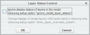

I created a curve in a part, and can select it in drawing mode. In drawing mode, however, i cannot dimension the curve, and I cannot permanently display the curve. Any suggestions?
note: this is a projected view of a part from a family tree.
Jan 25, 2013 10:15 PM UTC
What does your drawing layer status look like? In the layer tree settings, select "Drawing Layer Status.." and check/ uncheck the appropriate boxes. You can have the layers follow the models or act independently in the drawing.
[cid:image001.jpg@01CDFB0E.DA070720]

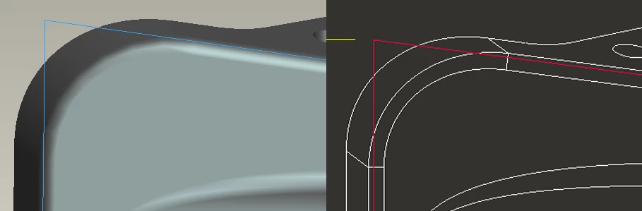

Does anyone know where the "Appearance Placement" controls are in Creo 2? This is where you can change the scale and placement of a mapped image on a surface.
What it looks like in WF3

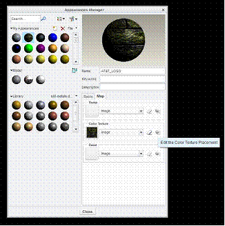

This option is grayed out, not sure why??
