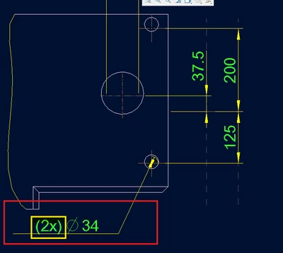

In any drawing which contains holes normally (written manually (2x) M12)   How can i make the number of holes should be automatically generated ?

I am trying this in Creo 8.0,
currently i am writing it manually, i am looking for the default option, it can calculate the number of holes automatically

Feb 25, 2025 2:19 PM UTC
Could you give more information, where to write this &p# should be written
