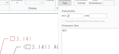

How to show diameter symbol? Right now the symbol is a box
Why is the diameter symbol box shape? Wherever I dimension a round feature, it show this box as diameter symbol (and R as radius symbol). However, in a different drawing, the correct diameter symbol shows up but with bold font, which is another problem.
I have waited for several days before posting for help. Which configuration options should be checked?

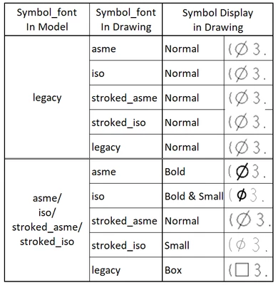

Dec 8, 2021 5:47 PM UTC
The above is the outcome of my experiment upon Stephen's hint.
Please insert it into CREO's help manual (which is not user-friendly at all!)

I assume this is an older drawing/model. Something changed several years ago that messed with fonts. I think the solution was this:
symbol_font legacy option must be set in both the model and the drawing.
Model
File > Prepare > Model Properties > Detail Options > change
Drawing
File > Prepare > Drawing Properties > Detail Options > change
I found the above info here:
https://community.ptc.com/t5/3D-Part-Assembly-Design/Symbol-Font-DTL-Option-does-not-apply-to-dimensions-only-to-text/m-p/547224
JS_982441215-MoonstoneAuthorAnswer

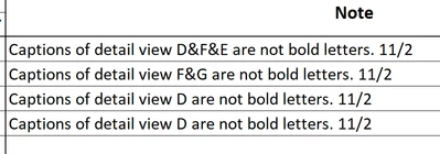

Dec 8, 2021 6:02 PM UTC
The above 4 issues have never been resolved since 11/2. Does anyone have a hint to set all captions of detail views in the same drawing to have the identical font configuration? Thanks.
