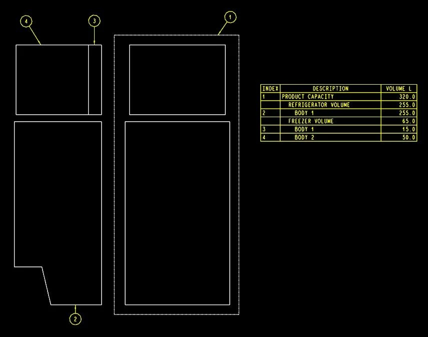

I am having trouble to get the result as shown in the picture.
How to get parameters of each part´s multibody in a table?
I know I have to create a parameter for each BODY, including each PART and for ASSEMBLY.
REPEAT REGION allow me to get parameters from ASSY and SUB ASSY, as so as PARTS, but there is no option to insert a parameter like ASM>MBR>BODY>USER DEFINED.body_report.jpg
February 25, 2026
I haven't used multi-body parts yet, but if you create different parameters for the different bodies, you should be able to show them with the ASM>MBR>PART>USER DEFINED option. (ex. BODY1_VOL, BODY2_VOL)
