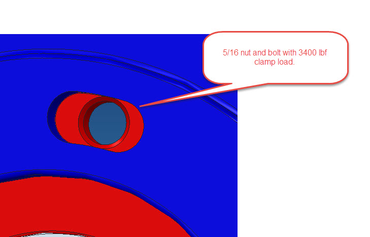

How to simulate a bolted joint with a round hole and slot
I have a assembly with two parts that use a round hole and slot for the bolted joint. I cannot use the fasteners tool due to the slot, how do I model the bolted joint?2014-08-04_14-15-35.jpg

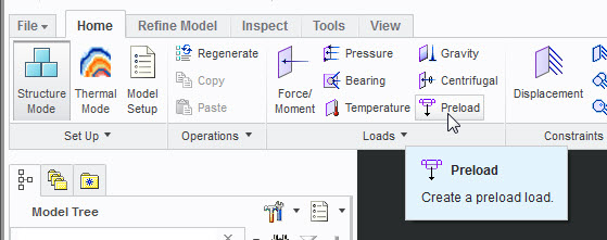

Have you tried solid models with the new preload constraint now availible in Creo 2 Simulate or newer?
dkeenan11-VisitorAuthor
Aug 4, 2014 7:05 PM UTC
I am using Creo 2.0, but I am not familar with the solid models and preload you are referring to. Is there a reference doc you can point me to?

Try using a simplified 3d model of the bolt and nut using the following
Sep 2, 2014 7:06 AM UTC
I have never tried to use the preload feature with a solid bolt that was an unique part (screw + nut), but I've always had screw and nut linked with a bonded region.
I think is the same thing, I don't see why not.
To apply the right preload you have to do like the fastener:
- apply a first preload F1
- put a measure of force on the area of the volume region where you've placed the preload or the thermal load on the bolt
- first analysis
- take note of the measure of force F2
- modify the preload in this manner F1^2/F2
- second analysis
Bye
