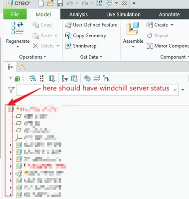

How to solve the problem of "Windchill Server Status" not displaying on the Creo model tree?
My colleague's computer can display windchill server status. My computer cannot display. How to set it to appear?

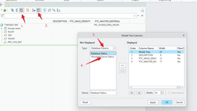

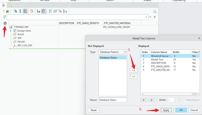

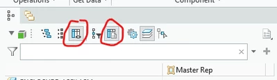

I only have Creo 7 connected to windchill.  For me this button controls showing columns.
Looking at Creo+ (13), the first circled button controls the showing of additional columns and the second one controls which columns to show.
