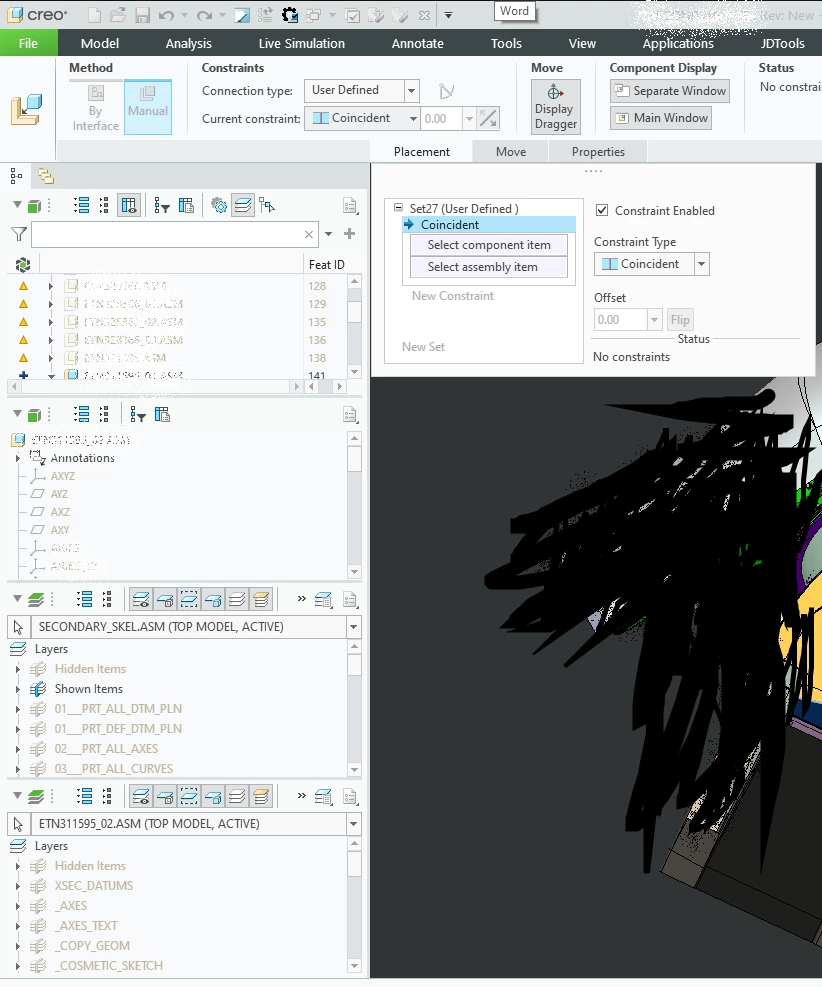

I have the same complaint. Even worse, when I assemble a weldment .asm into a top number .asm using "Seperate Window" BOTH layer trees expand and so my side bar is broken into 4 windows.layer_tree_trouble.png

Config auto_locate_in_tree no will stop the auto expansion, but will also not highlight anything you click on in the tree.
I also set config floating_layer_tree yes to get the layer tree out of the model tree.
Oct 31, 2024 3:05 PM UTC
Thank you. I need to keep the auto locate on but I will try floating_layer_tree.
