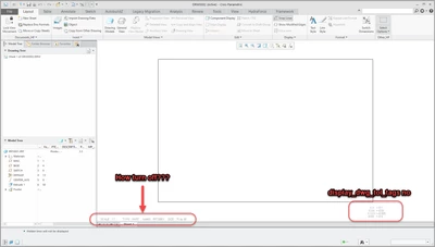

How to turn off floating gray tag text on drawings to save as a clean image (e.g.png)?
See image below:
The config option "display_dwg_tol_tags no" turns off the 4 lines for the tolerance tags however I also want to turn off the other side which shows:
  • Scale
  • Type
  • Name
  • Size
Alternatively since I really just want to export a clean image of a drawing, if you have any other way to create an image that can be clean, please let me know (I don't see any configuration options in the save as .png dialog)...?
Thanks, Lawrence

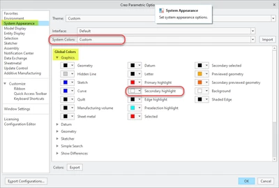

Although it doesn't exactly get me to the final destination, I did find a workaround to hide the gray text for direct save as png file type.
  1. Set background color to white by setting system colors to Black on White
    • File: Options: System Appearance: System Colors: Black on White
  2. Set Secondary Highlighting to white
    • File: Options: System Appearance: Global Colors: Graphics: Secondary Highlighting to white (by setting color pallet to R:255 G:255 B:255)
    • When this is done the system colors change from Black on White to Custom, which is fine but is why the attached screenshot shows custom.
    • For reasons I didn't explore, changing secondary highlighting doesn't change the color of this text when on the good old black background drw (or blue background model).  Thankfully I found it anyway since I needed a white background but one could easily have missed this and thought it was not possible to change the color of the floating gray text.
Unfortunately, the scaling and the fickle resolution 'control' based on zoom level may still be an insurmountable problem for us.  Feel free to post anything else if you find something that may help.   Thank you all for your ideas and help in this thread!

kdirth
September 1, 2020
Use Save As.  You can choose png.tiff or pic.
I always save as pdf.  This preserves scale and can also be resave as an image if needed.
Chris3
September 1, 2020
Its confusing, but there is a tiff "printer". If you go to file -> Print and then click the "Settings" button. Next to the printer field there is a +drop down arrow. Click "Add Printer Type" and then pick TIFF from the bottom.
Choose print to file and then after you have browsed to a file location, change the extension to .TIFF
