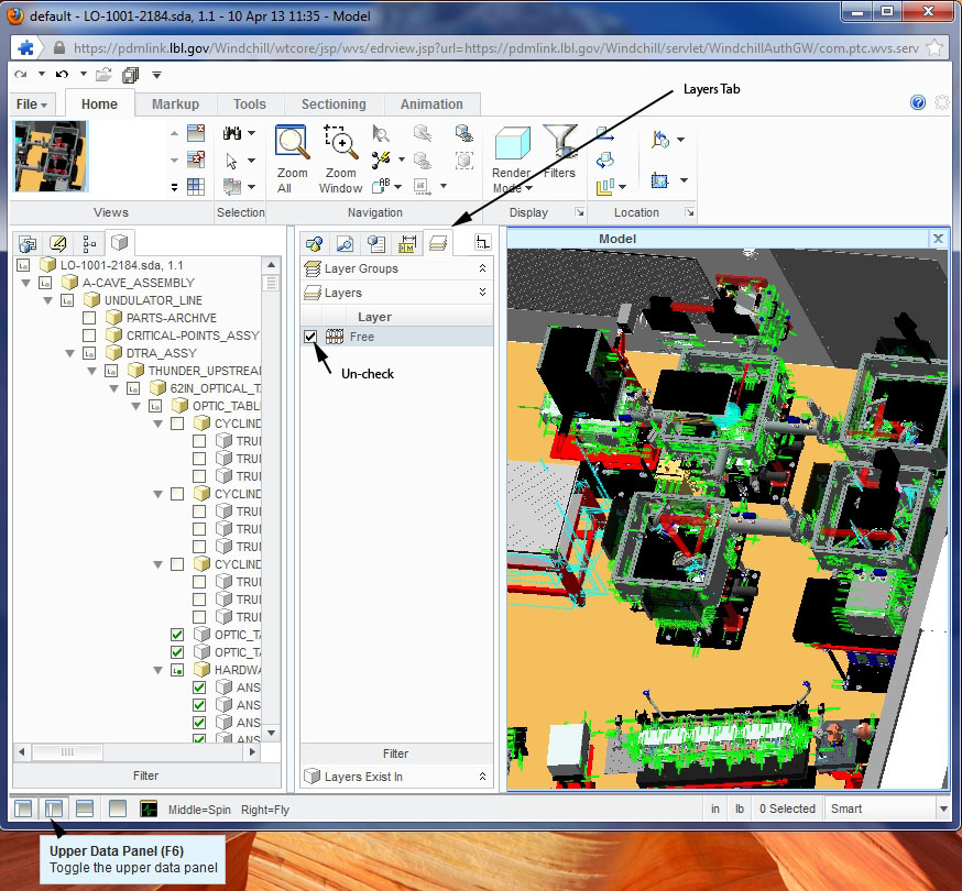

I can't figure out for the life of me how to turn off the plane and object labels. My assemblies are obscured by a forest of bolt descriptions. It's not a layer thing, so how do I do it please?

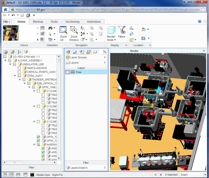

I had what I think was the same issue and was helped by a person at PTC on this. If you go to the "Upper Data Panel" button on the bottom left of the Crea\o View screen, then hit the "layers" tab, then uncheck the "Free" they can be turned off.
