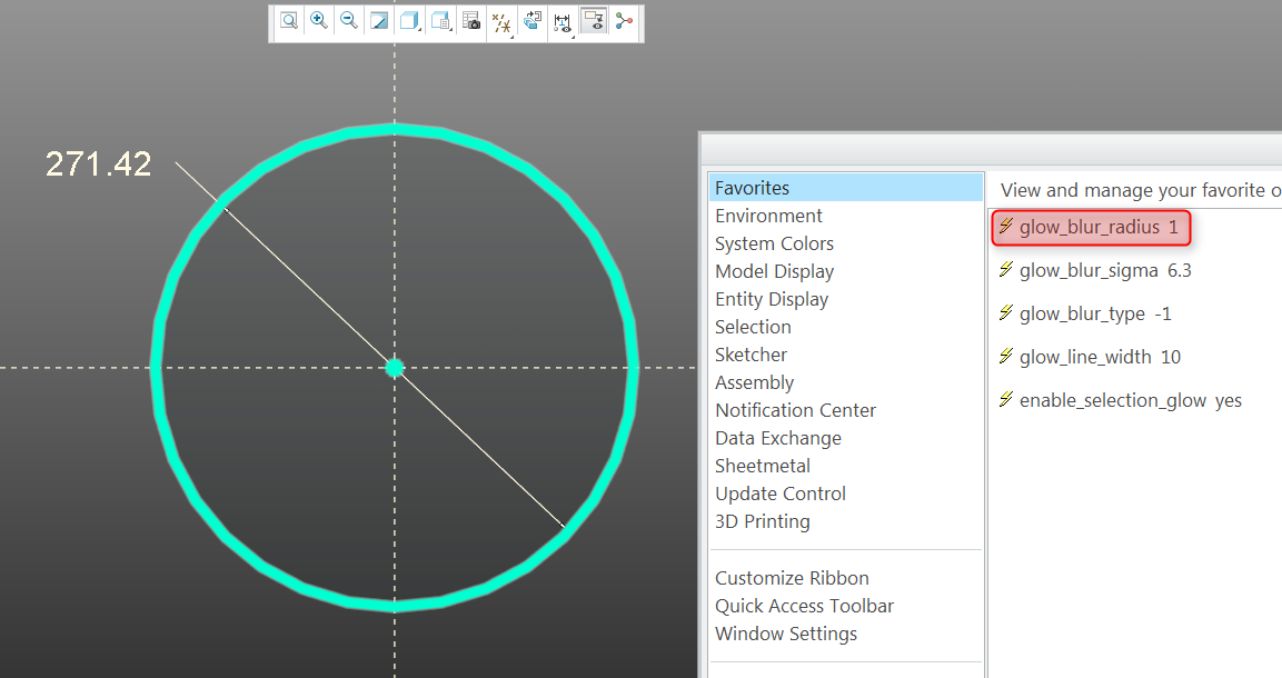

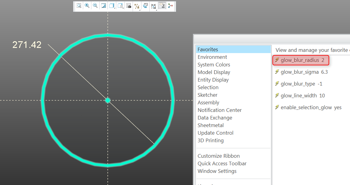

As captured picture below, how can I turn on neon effects for selected feature or dimension lines?

You can turn on this option by inserting the following line in config.pro
enable_selection_glow yes
Thanks to James Lim in Digitek for giving this tip to me.

It is a hidden option. Just type it in your config.pro with text editor.

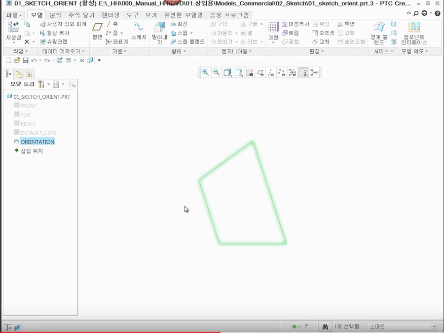

Patriot_1776
December 29, 2016

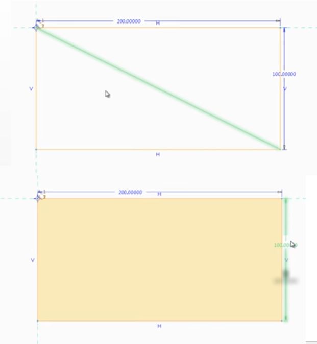

Ok, so, I wasn't able to see any change in drawing mode, though it was a quick check.  where I think I like it the most, is in sketcher mode.  It REALLY highlights constraints, sketched entities, and other objects well.  Again, just a quick test in sketcher, but I think I like this setting!

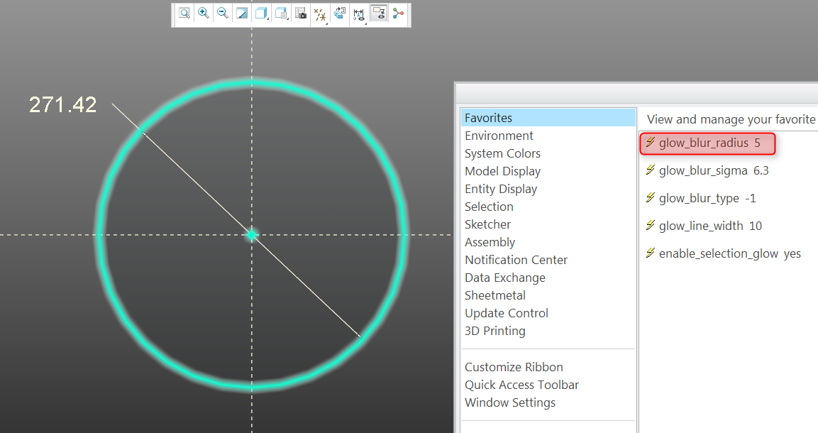

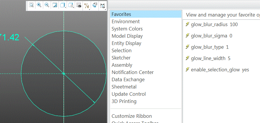

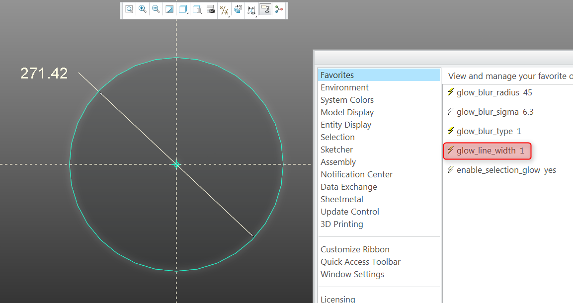

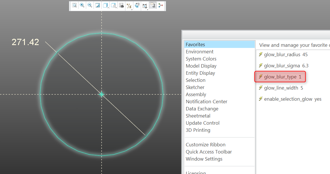

For those that are using neon effect here are some extra neon display control options:
glow_blur_radius     1
glow_blur_sigma     internal
glow_blur_type        internal
glow_line_width      2
Patriot_1776
December 30, 2016
The problem with hidden configs, is that there is no explanation as to what they do.  I tried the above configs, and didn't like them.

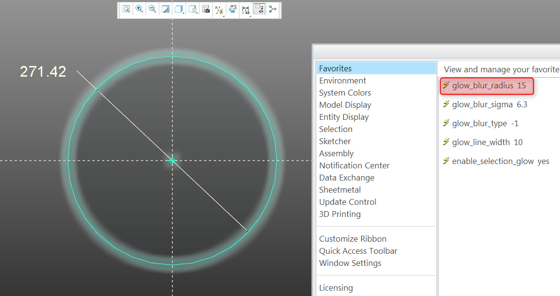

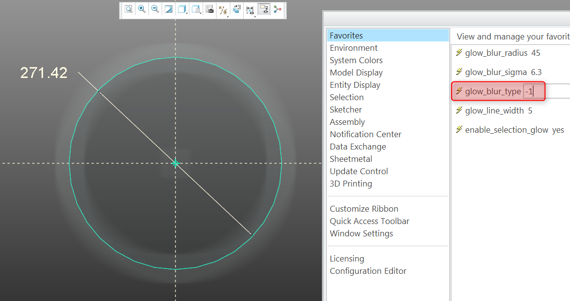

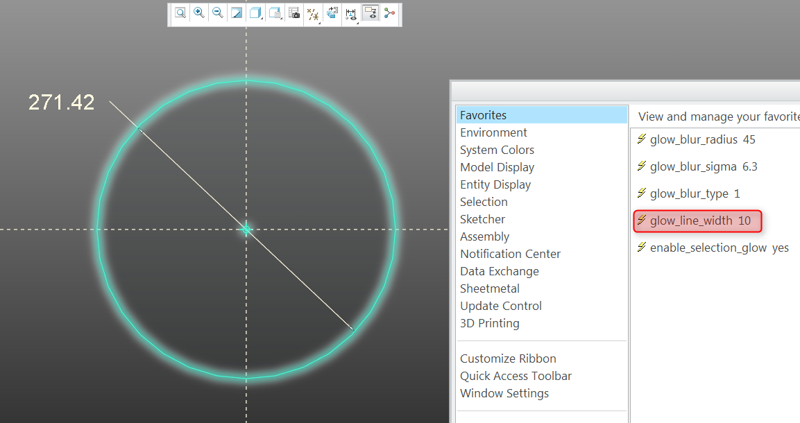

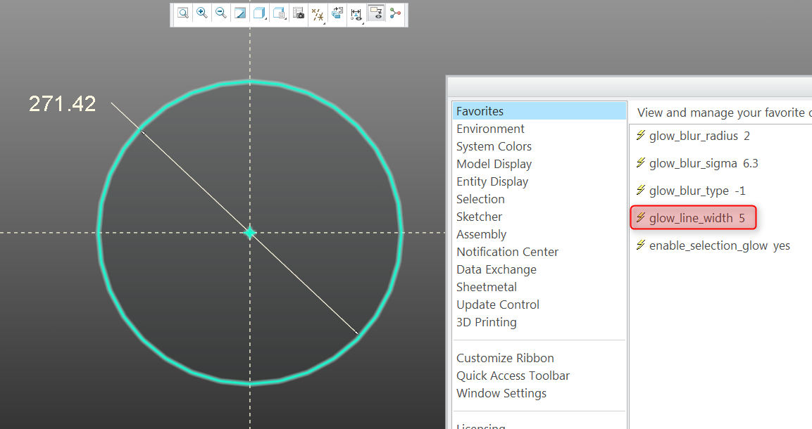

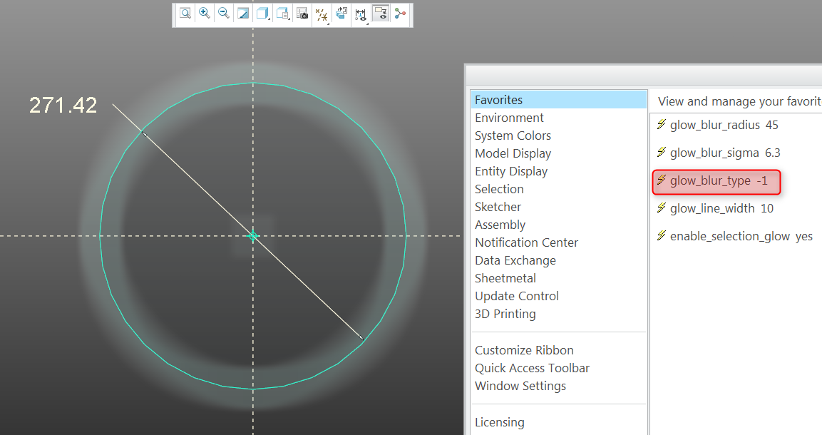

December 30, 2016
glow_blur_type:
  • 1 fading glow, further from line, less intense
  • -1 flat glow, more like a wide-transparent flat line behind selected object  (my preference now)
glow_blur_radius:
  • width of the blur, but is dependent on the glow_line_width
glow_line_width:
  • width of the base highlight line that is blurred.  when blur-radius = 1 the selection will be wide and opaque.  when blur-radius larger, the glow-line will be more transparent but the wider the line_width the more opaque the highlight appears.
glow_blur_sigma:
  • [edit] default value was 6.3.
  • 0 gives no highlight
  • 1 barely any glow, only a thicker line
  • 3 starts to show a glow
  • 6 default look
  • 12 getting toward a more flat look
  • 24+ gives same basic effect to the glow_blur_type -1
sigma adjustment from 0-24+
Some examples of different values when changed.  Also note, I have my "selection color" set to a neon green because the magenta selection color is not as "highlighty" to my taste.
