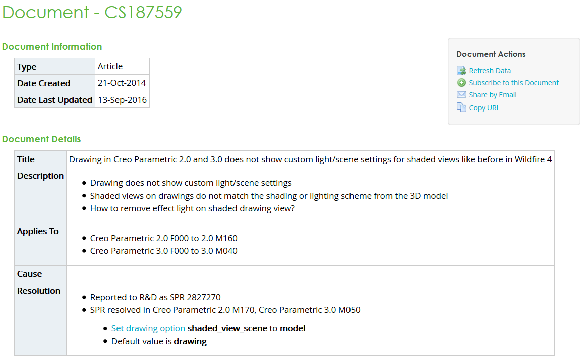

Somehow when I change the lighting on the model (change lightbulb position, intensity) it doen't update the values to the drawing. Is it possible to insert the same values to the drawin view? And how canit be done?

what happens when you add new shaded view in the drawing ? Is it identical with older view -OR- does it show updated lighting ?

the photo above show a new 3d model with its standard lightning setup. inserted in the drawing it seems the drawing view calls it'ss own lightning & shadow values

please test this information.
