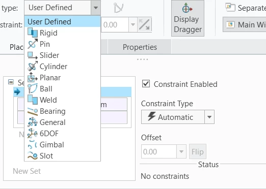

You can do this with mechanism function. You have to change the connection type in assembly.屏幕截图 2025-03-30 161541.png
For example, for a rotating part choose pin. After that, go to applications, mechanism.
Add some servo motors and than do a mechanical analysis, than choose playback, now you can export as a mpeg video.
