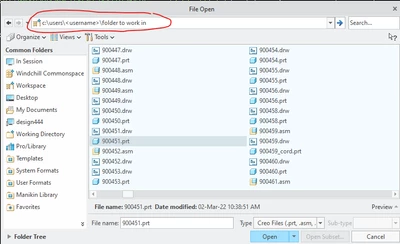

I was able to finally get it to work after doing the following:
Make sure not to navigate to a folder location but type in the full path to where you want to save or open something from!
You're file paths should look like the below text when viewing the mapkey in the config.pro file
mapkey(continued) ~ Input `file_saveas` `opt_EMBED_BROWSER_TB_SAB_LAYOUT` \
mapkey(continued) `C:\\Users\\$username\\Documents\\folder\\sub_folder\
mapkey(continued) ot_Delete`;\
mapkey(continued) ~ Update `file_saveas` `opt_EMBED_BROWSER_TB_SAB_LAYOUT` \
mapkey(continued) ot_Delete`;~ Activate `file_saveas` `opt_EMBED_BROWSER_TB_SAB_LAYOUT`;\
mapkey(continued) ~ Activate `file_saveas` `OK`;~ Select `main_dlg_cur` `appl_casc`;\
My mapkeys now work 🙂
