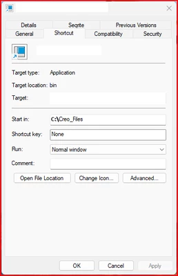

Are you using the same shortcut to open Creo every time.  Each shortcut starts Creo in the folder specified in the shortcut.

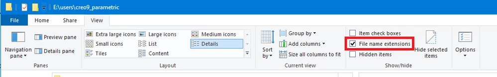

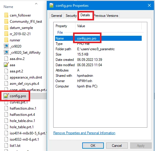

the name of config file must be config.pro.
In Windows  File Explorer hides extensions of known files by default. This can result in the configuration file being incorrectly named. See following picture
Solution:
Turn on extension displaying and rename file to config.pro

I follow this practice.
Create a folder for all your Creo files say "C:\Creo_files".
right click on the Creo 7.0 shortcut on the desktop, click on Properties,  and set the "Start In" to "C:\Creo_Files".
Copy the config.pro to "C:\Creo_Files".
Re-Start Creo.
Creo would now start in C:\Creo_Files and load the config.pro too.
