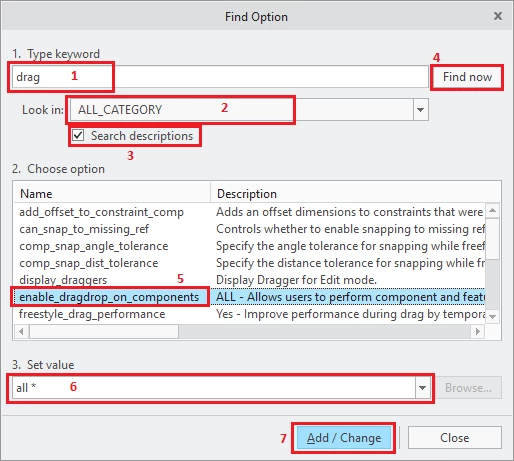

after my Creo Parametric was updated to 4.0 I can´t drag and drop a part from an assemble to another one. I can only move the position by inside the same assemble but not to another. Someone knows if there is some configuration I need to change?

Check out the config.pro option:
"enable_dragdrop_on_components"
The default setting is "all" which allows restructuring.
If it's set to "reorder", then restrucdrag.jpgture is prohibited.

sorry but where can I find this window "Find Option"?

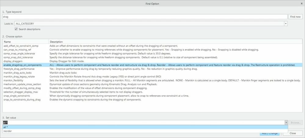

I could find where is the "Find Option" and I got to solve my problem. Below and attached I am adding some more information with sequency of numbers is necessary to set up to add this configuration:
File >> Options >> Configuration Editor >> Find...
Follow the sequency attached
